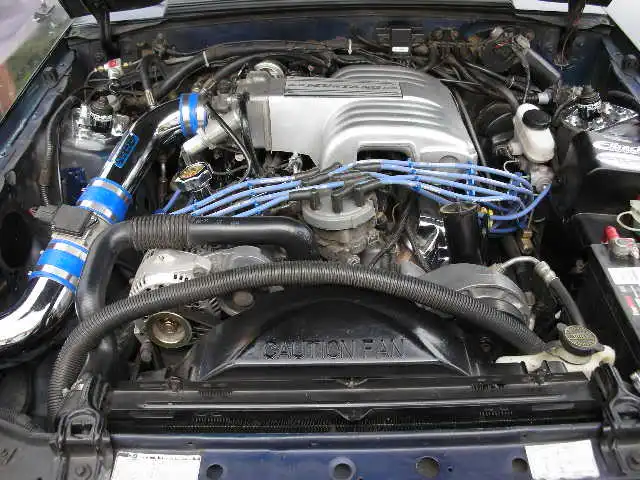

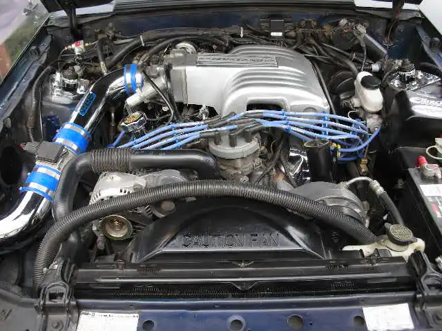

Here's my stock engine w/ a 3G alternator. The alternator brakcet just had to be nothced a bit as to not interfere with the housing.
I found the educational experience to be well worth it, at the time that I did mine. Plus not having your headlights dim, on cold rainy nights, everytime you touch the brakes is a bonus.
I have no stereo and a stock fan and I still would do it again.
