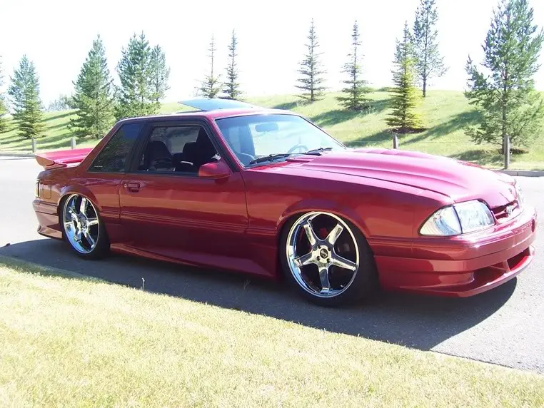

will 18" wheels fit under a foxbody
I'm running 18x9/10 with no problems here...

Kabuki_notch said:
anything special to make those fit Mineralgsvt? im seriously considering those for my cobra
Well, mine are 5 lug, but I'm pretty sure they offer in 4 lug.
My setup..
95 spindles up front, North race car brackets, stock length axles, flipped quads, rolled fender lips (not sure if this is needed but didn't want to chance it).
** btw, they would look awesome on a black cobra! Good Luck
