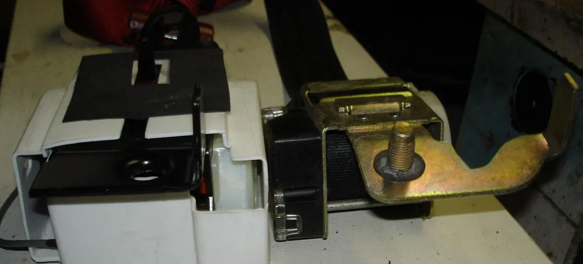

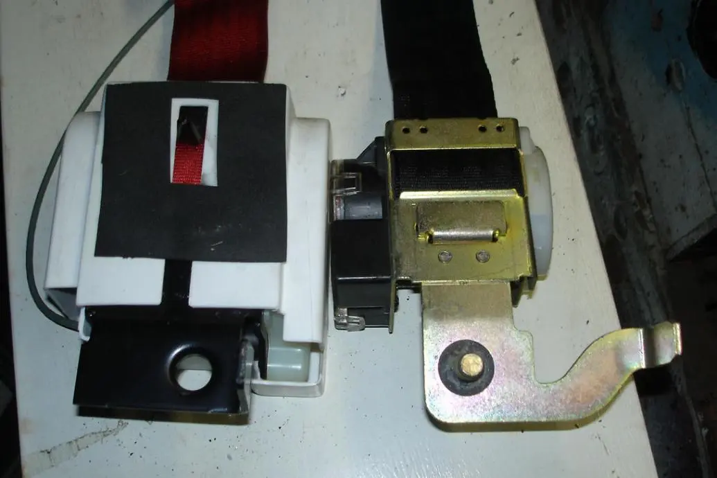

I have my old 1988 red belts still. I'll see if i can get a pic of them with the Sn95 belts i bought this weekend

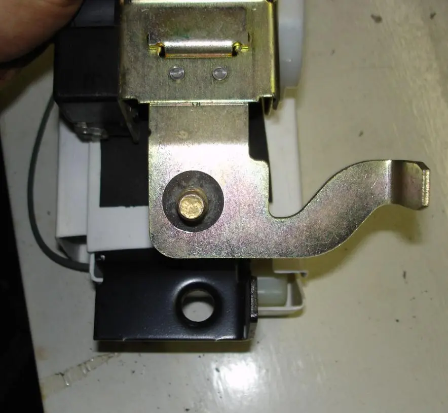

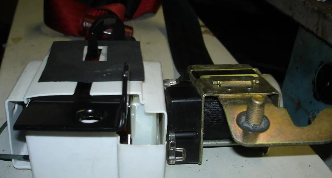

Here ya go.
Red belts are out of my 1988, but they would be the same as your '89. I beleive the SN95 belts are from a 1995, but i don't remember.
Disregard the bolt on the SN95 belts, the clip is holding it in place. If has a hole just like the fox belts.
On the fox belts, you can kinda see a small triangle alignment tab on the top of the belt too. The SN95 belts don't have this.
The pics should explain the obvious difference. My guess is ford moved the alignmet tab further out because it would give the belt more leverage to prevent it from spinning in a crash? :shrug:

Looking at the last pic, you could prob cut the SN95 tab off about 1" out and belt it 90* and make a new alignment tab.
