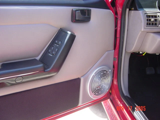

I'ts pretty tight in there. I ended up going with 5 1/4" I believe. They are Boston Acoustic. Even they didn't clear the stock speaker grills, so I made some custom billet ones to give me the extra 1/4" I needed.
