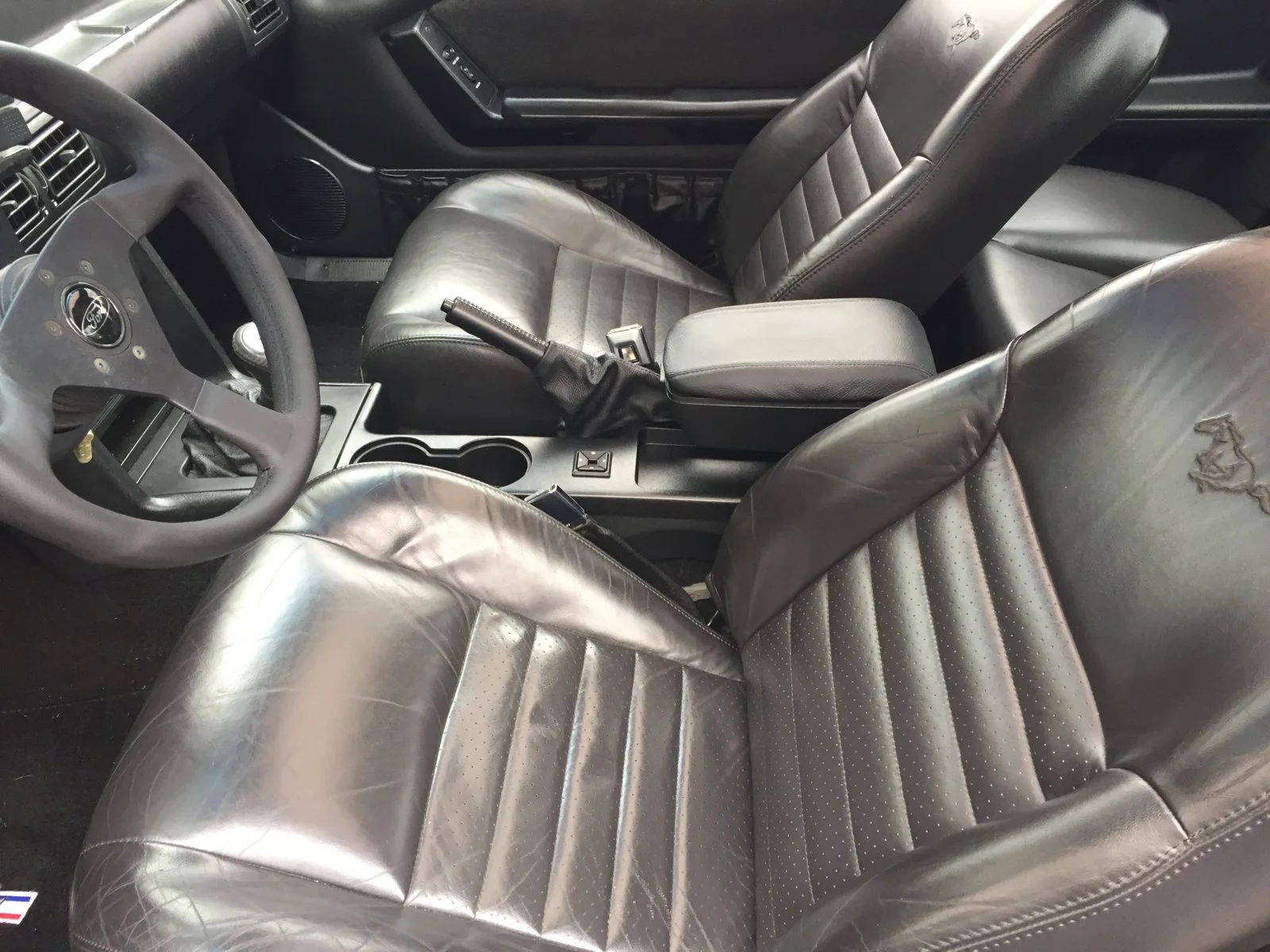

I doubt he’s posting it . That was 2007 .... you can use female spade connectors on the factory fox plug and the seat will work fine . I have my 03 cobra seats wired up this way for a few years now no issue
I can probably dig the harness up I made for my SN95 seats and take a picture.
What I did was take the power lumbar plug off an 87-93 seat, and the body side harness off a 99=04 seat and spliced them together to make an adapter harness. Then I just used it to plug the power base from my 99+ seat into the fox lumbar power harness.

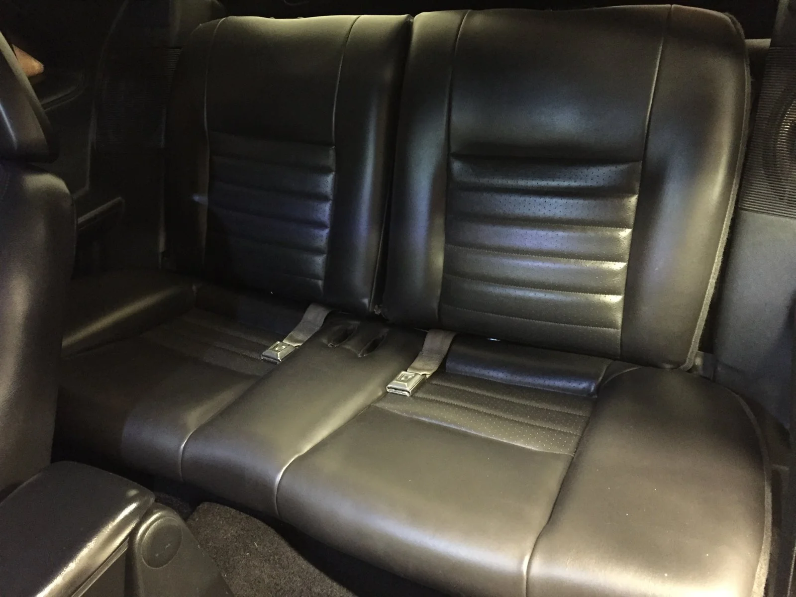

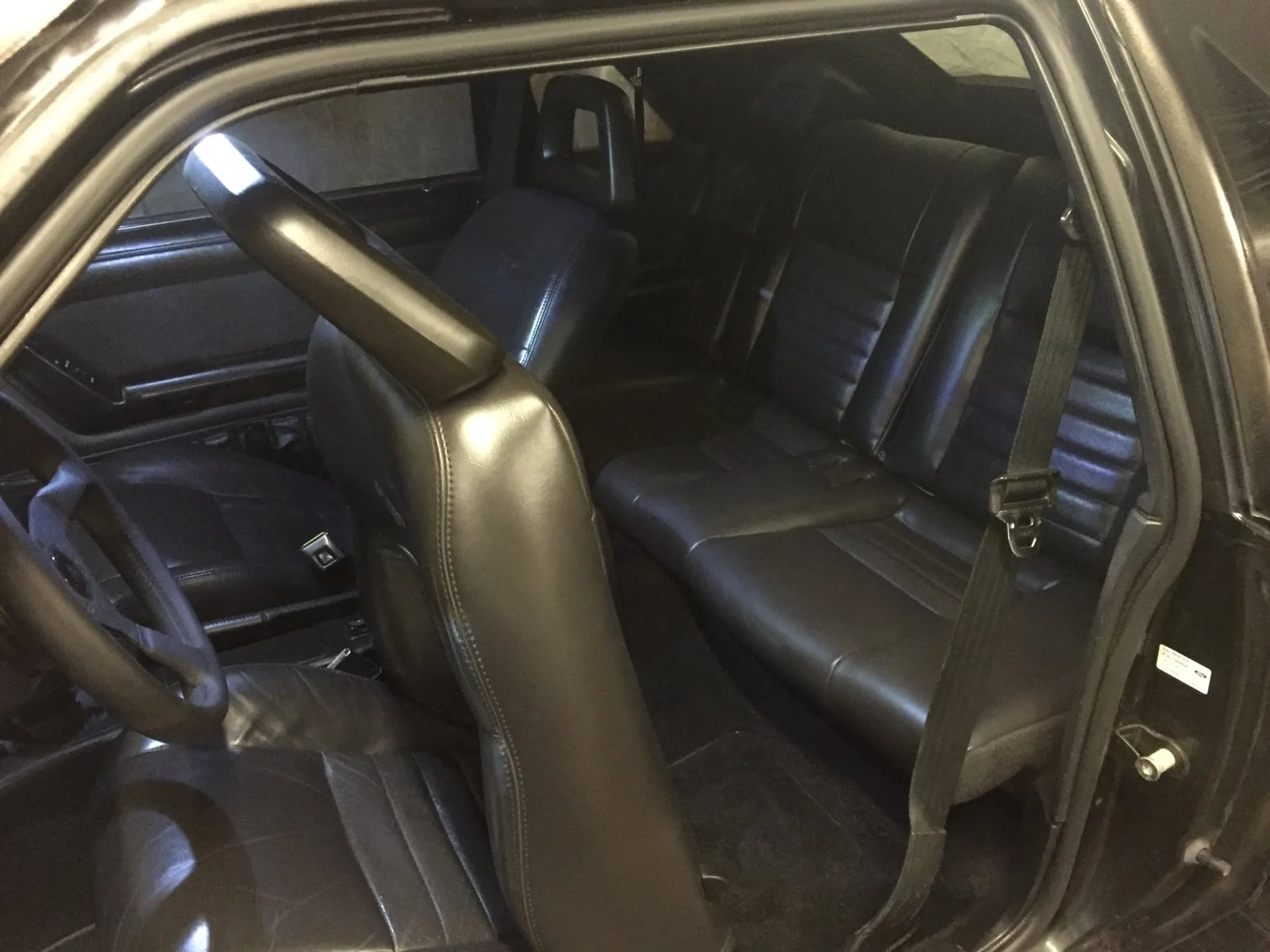

I used to have front and rear seats from a 99-04 in my car. Not anymore.
