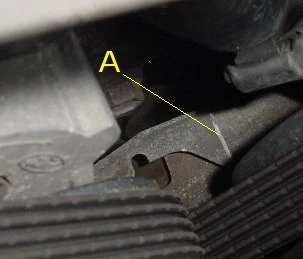

when i set the timing before i didnt use where A is labled. i used where the little notch is
but today i tried setting it to where A is and it wont let me turn the dist that much, it just wants to stall out :(
ive tried moving it over a tooth on the dist but no change

Since you've already moved things, you should probably bring the engine to TDC and re-stab the distributor.
Also, is it possible that your elastomer is separating from your harmonic balancer? I'd give the outer ring a good shake to make sure it's still attached. That would also cause your timing marks not line up (and would be something to fix right away if it was on its way out).
It will not run if the distributer is 180* off. It will give you a nice loud backfire when you try to start it with the dist 180* off though. Ask me how I know ;)
Your timing may be off but the distributer is not in wrong if it runs.
You can run the distributor 180 degrees backwards, just put the plug wires on backwards and be sure to remember you done it, otherwise it'll never run after a tuneup! lol.
Anyway, I second the Harmonic Balancer, I'd bet it's crapped on you and outside has slipped, causing your timing marks to be off.

like i said i oridg set the timing using that little cutout area of the timing pointer (set it to 14deg) and it ran pretty good most the time, once and a while it would feel sluggish and buck a little. i thought it was just the injectors. over the winter i read someones thread about setting timing and realized i had set mine wrong so today i wanted to set it the correct way using the side of the pointer like in the refrenced picture
the thing that made me think maybe i was 180 out was that when i turn the dist to get the mark anywhere near the "A" the car wants to stall out. do you think its possible with the balencer i have im actually supposed to use the little cutout to set timing instead of the "A" location?

FMS-M-6316-B50 <-the balencer i have
*pic and specs*
