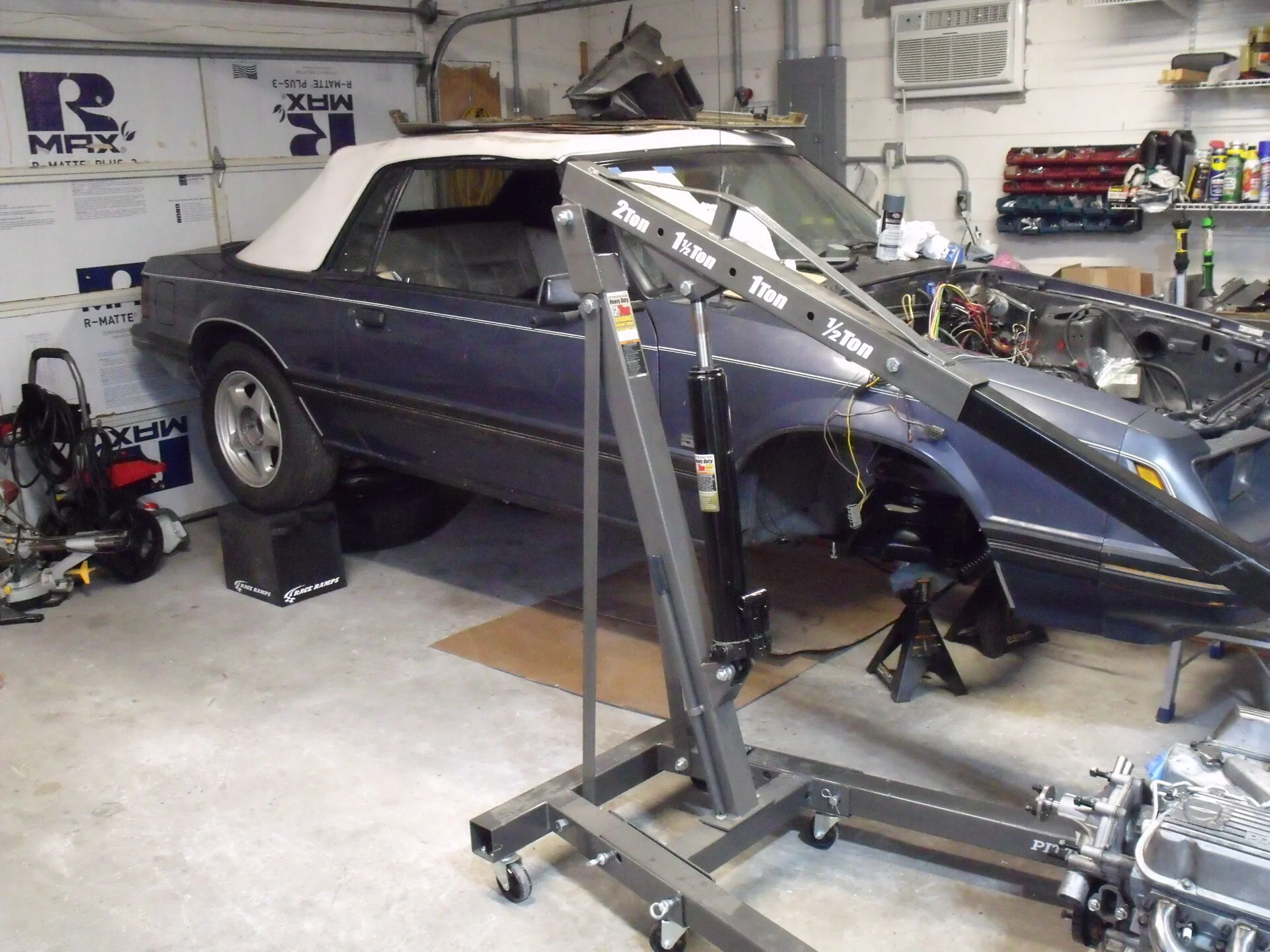

So to sum up things here I found my old coil ( I plan on buying a new one) and installed it in the bracket and physically held it up where the newer TFI coil would go... Actually might not look too bad and maybe keep things "simple" which is good for me.. After all I am just a deplorable....
Installing a newer different sized brake booster, so I need to get that installed to make sure what room I have, including air intakes for the air cleaner...... Wiring comes first, so it will be a while.... Good news is my MM order that's been BO for 5 weeks was shipped yesterday, So when it gets here can put my front end together and see how my 5 lug upgrade decisions workout....... well, at least for the front suspension.......
Thanks all for the help......
