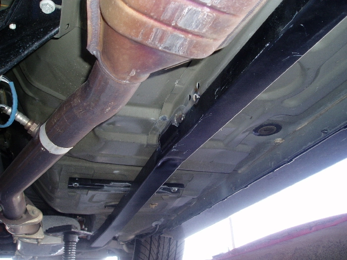

They improved my ride quality. Took out a lot of rattles and squeaks.

You're missing a reinforcement plate and gussets in that picture!
I honestly didnt' feel crap from my SFC's...but I only got them so I could later add a torque arm :nice:
Yea the shop that installed mine had done the MMs so many times that when I asked them about the plates they had never heard of them.
I drove back over there, and they had the plates laying around somewhere in the shop.
They welded them on no charge.
