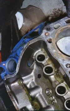

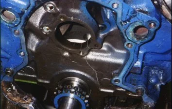

You might consider upgrading the block before your stuff any quality parts in a stocker for that horsepower level.
Or...........

Those pics are a late model block. They are weak compared to the early stuff. I had a 302 with stock rods that I shifted at 7500, so with good rods, 6800 with a 3.40 crank should not be an issue. You would be suprised what can become boring. 500hp might someday leave you wanting more. If you ever think you might want N2O, go forged crank. Nitrous or not, you need forged pistons for that rpm.
Not to argue or anything, but I'm one of the ones that believes the later blocks are stronger. Theres no inherent answer which is stronger, but just pointing out that the reason it broke had nothing to do with what year the block was.
I tend to agree with you on that, but I have since began to wonder if it's true. I have had no recent experience with older small blocks, only the newer roller 5.0's of which I've just had my first block failure, a crack developed in the #4 cylinder wall of the 400HP 40 over 5.0 roller motor. I think that overall the casting quality is better in the newer blocks, than the older ones which should lead to a stronger block , but the question of which is better may never be settled.
The main webs are thinner on a late model block. In the early days engineers did not worry about weight. They have been taking metal out of the main webs and the pan rail since the early 70's. The hp ratings for a hipo were at 6000rpm (2870fps piston speed), that is with a stroke of less than 3 inches. The 428cj some were rated at 5400 (3582fps) others at 5200. I have never owned either of them, but piston speed at these levels is still way lower than 6800 and 3.40 stroke. I would not build a motor with a short rod (5.4) and a 3.40 stroke and rev it to 6800 (3853fps) very often w/o forged pistons, too much side loading on the skirts for cast pistons. Also look at the hieght of the piston from the top to the bottom of the skirt. Another reason for forged.
