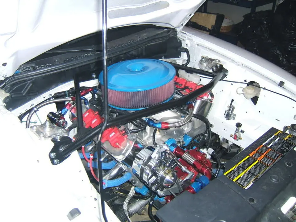

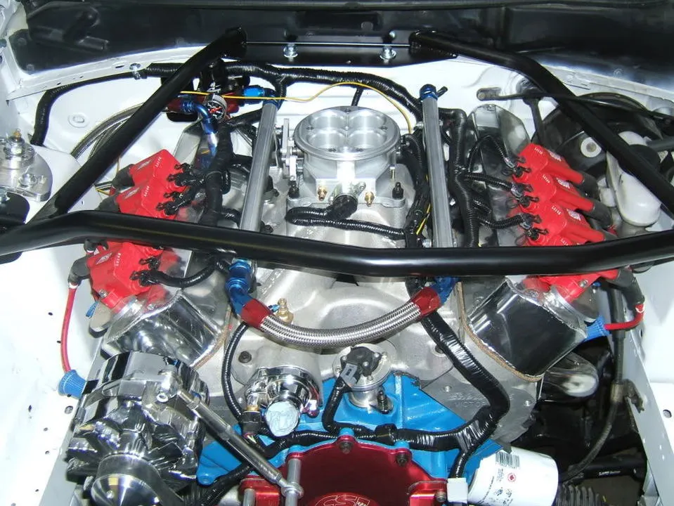

Here is a pic of the exhaust so far. This is being fed from BBK Long tub headers and the exhaust is 3". The mufflers are Mac Pro Dumps
This is the power plant that is feeding this system

It is going to be on the edge. I am hoping for 500 flywheel horse power but it will be alot higher once I get my nitrous installed. It is going to be interesting. I guess will just have to keep an eye on them. As for my setup it isn't TBI it is multi port. When I built I wanted to give it an old school look so I hid as much as I could. here is a pic of the engine from a while ago with no air cleaner on.
Nice! I like it! :)
As long as you realize that you'll lose some low-end, and high-end without going to a tuned port input. IMHO, I think that you'll still have plenty HP, and on the quarter mile track, hooking fully/properly up will be more of a limiting factor until you get that all dialed in.
Also, that means that you're running either a Mass-Air setup with the MAF disabled, or an SD setup. People have had success with both at that HP.
