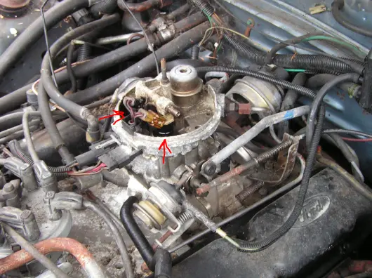

Just the autos had them but they looked like the carb cars
You can see the two fuel injectors in the “bowl”. With the air cleaner on youd never know although the air cleaner lid does say “5 Liter EFI HO” on it

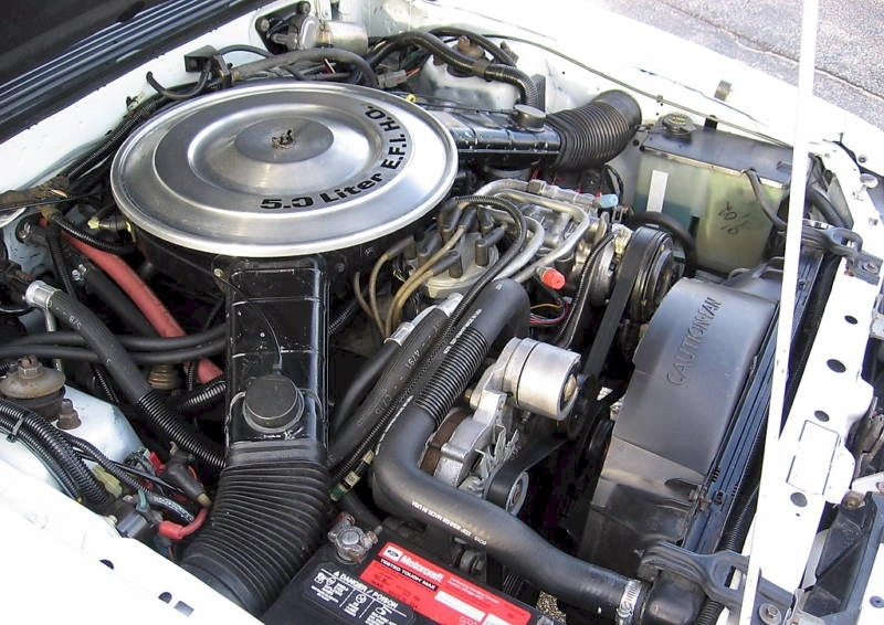

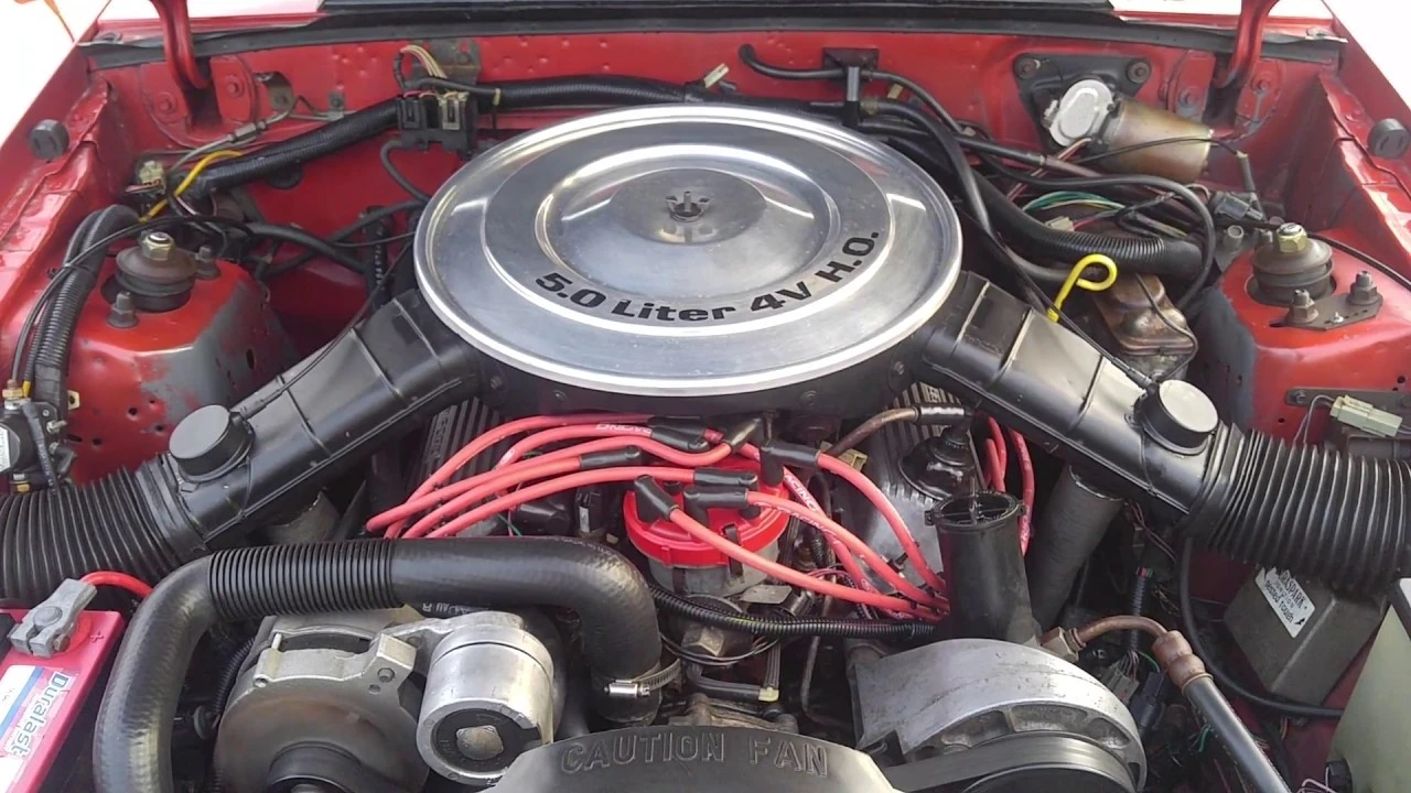

The CFI and 4V carb engine bay layouts are pretty similar
Carb
Vs CFI
Spot the difference
Reactions: Gs1987GT and 7991LXnSHO

Thanks! I was going to look for pics like these. I even see three letters.

This is exactly what it looks like. So my car was efi? Most likely

One lid says EFI, the other does not. Although the lid could have been switched or the letters worn off.
Also, what transmission do you have? That’s harder to change than the lid.
