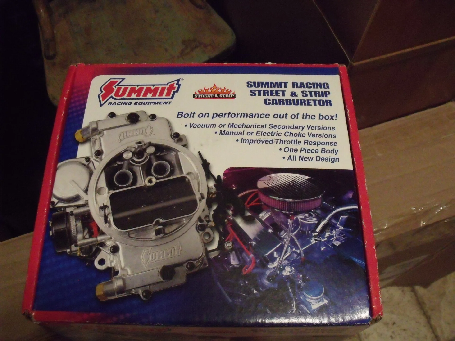

I remember so many over carbureted cars from my youth I am going to try something different..
No race car, just a grocery getter... 030 over Explorer engine, "P" heads, TF Stage 1 cam, forged pistons with a goal of 9-1.... shorty headers with the stock aluminum intake that came on the car.......
I purchased the 500 CFM carb in the pic to try out and see what happens......
If I ever get to putting it together and NOT taking more of it apart, I will let everyone on here know.....

Those are pretty good carbs in my opinion
A friend has one on a 76 El Camino
I had to fix it only once in about 10 years
I remember the repair being minor but we had to get the kit from Summit
You'll love it
Reactions: limp
You'll love it
Lots of good reviews on them.....

Are they ok with the sht ethanol laced petrol we have here?
What is it E15 or something?
