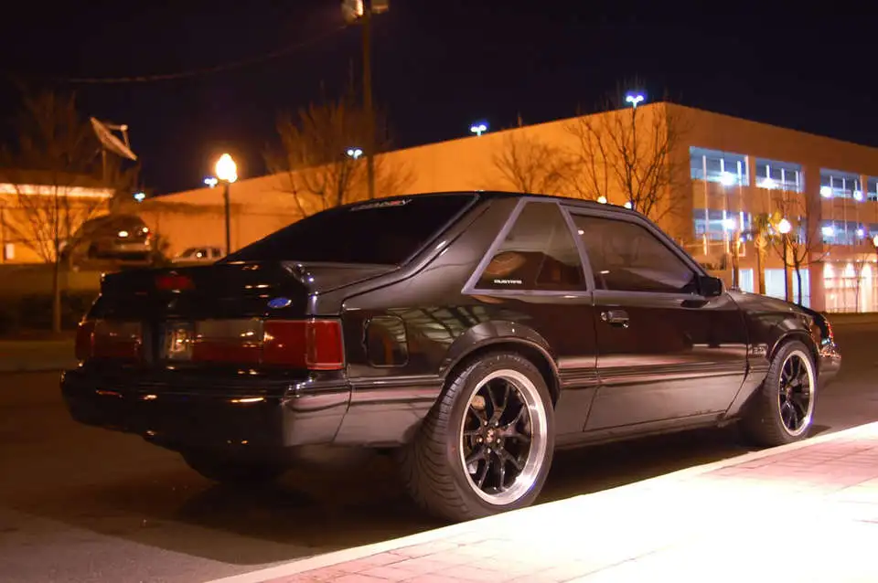

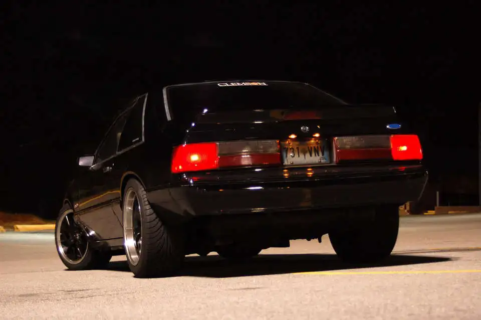

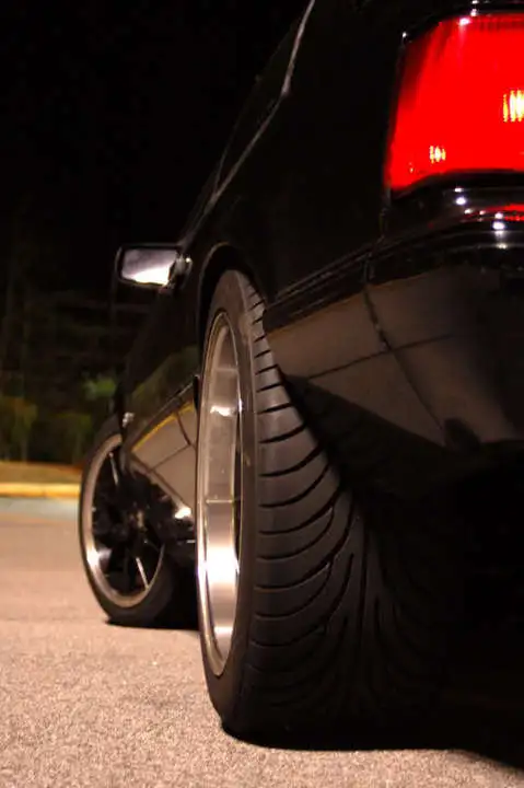

Okay guys I made an order of fr500 in chrome, 18x10 rear with 295/35/18 and in front 18x9 with 265/35/18 will these fit... I'm thinking they might work but not sure.... Okay right now I have 5lug conversion with 17x10 with 315/35/17r nittos drags and in front 17x9 with 245/40/17r (1990 mustang gt)

thanks for replying guy...... Right now I have the 50resto 5 lug conversion set up.. with (Bullets) 17x10 in the rear with 315/30/17 and in front 17x9 with 255/40/17 but i have a 1/4 inch spacers on all for wheels ... I'll take some pictures so you guys could see what I'm talking about, I just the fr500 cause they looks sick:flag: thanks for replying....
