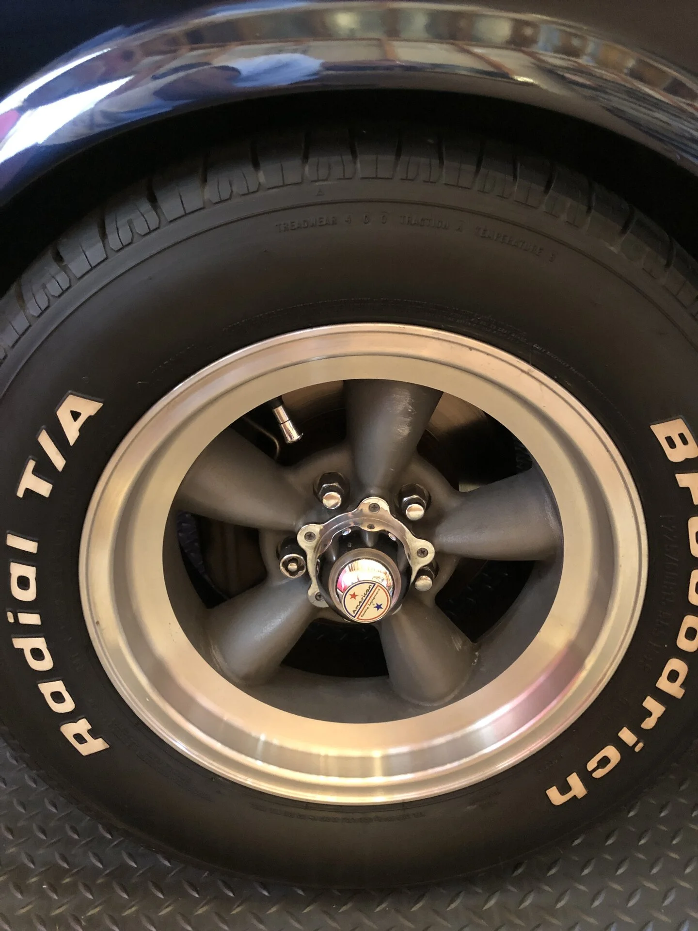

I'm having some rubbing on my tires on my 65 Fastback so I think my springs are gone. Any suggestions for this year mustang as far as upgrading the suspension. Thanks.

What wheel and tire combo Do you have, and where do they rub? If the rear wheel and tire combo is right, they should move through the full range of motion without rubbing. If they are stock, and the edges are rubbing, check for sideways movement from bushing and shackle problems. If they rub on the top of wheel tub, then I would suspect a suspension bump stop and the springs.
The Skyjacker look was to get wide wheel and tires with poor offsets to not rub too much in the 70’s.
Running this combo . 225 60R15 and it’s front tires only rubbing at the top. . Thanks
