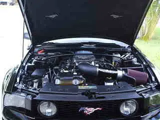

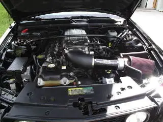

I have the GT500 STB on my car, as you can see it fits.
no problem with the hood clearance on my car, the hood isolator has a indention from the bar but no issue with the hood, my buddy had a problem on is 05 with it hitting the hood but all you have to do is put a washer under the bar on the backside bolts which tilts the bar forward enough to clear the hood.
