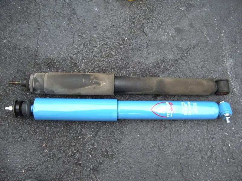

I'm running the fox Tokico's out back, I'll be getting the front fox struts in a few months. Here's a pic comparo of the stock '94 versus fox (3608) shock. As you can see, not much different:
