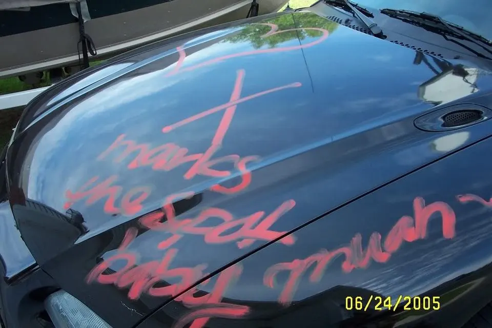

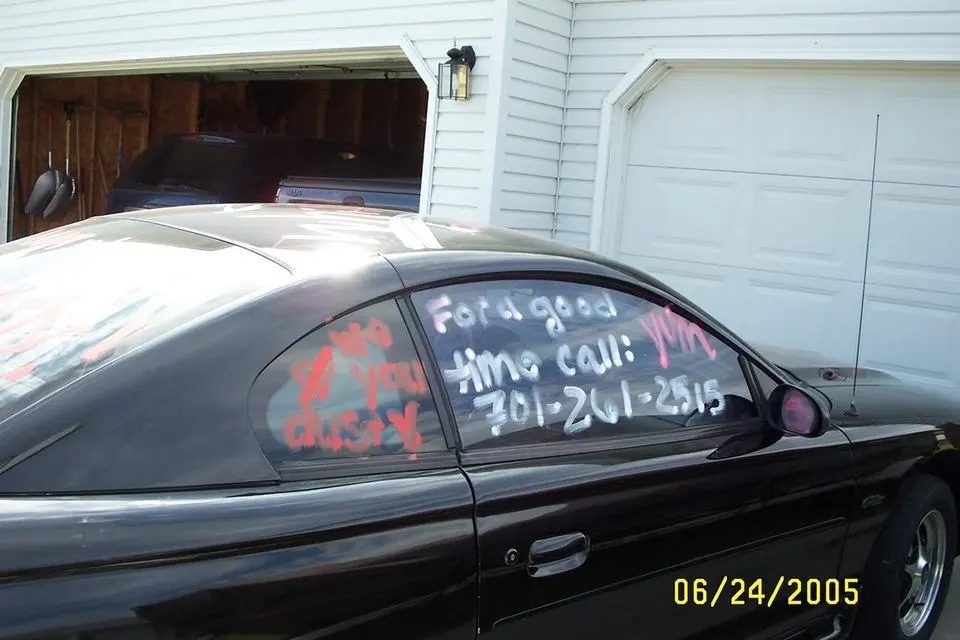

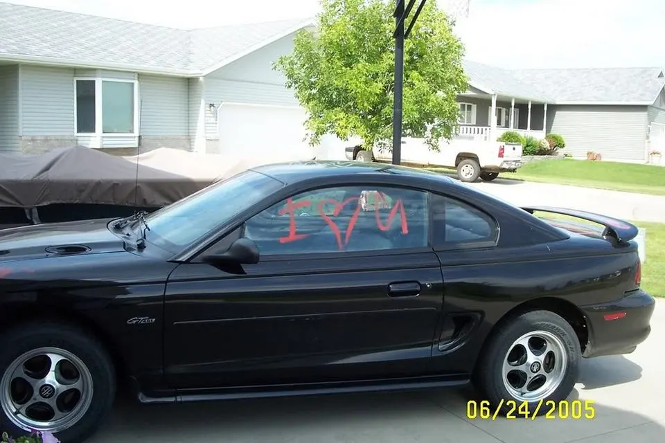

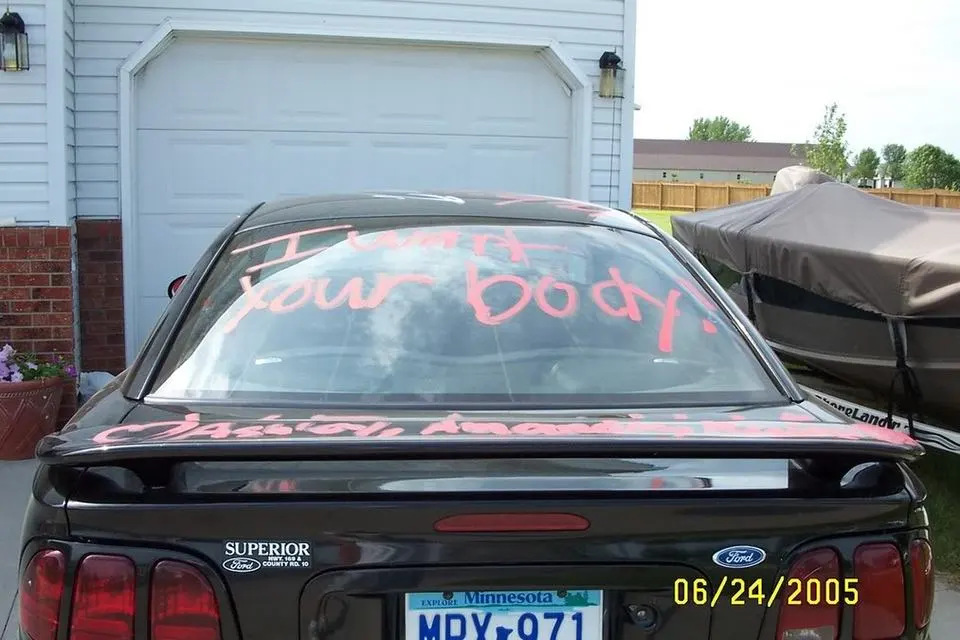

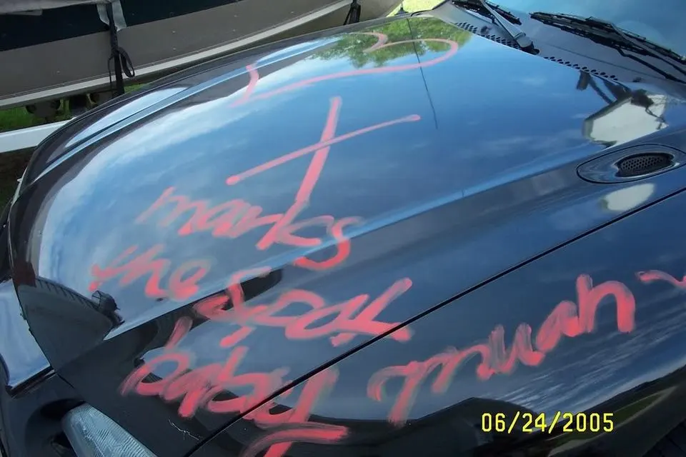

Ok so long story short my neighbor girl and her 2 friends chalked my whole car and now after a car wash and hand scrubbing the stuff barely comes off. Any easy way to get the stuff off the car??
EDIT: Oh yeah and this was 1 day after i spent about 4 hours washing/claybar/waxing it, yipppee??

Make them wash it in bikinis until it is clean then PIITB...
Seriously though, have you tried bug and tar remover that is clear coat safe? What exactly did they use to make the marks on your car? Keep it out of the sun until you get this resolved!
they used the car chalk marker things you can buy at walmart, made for windows, not paint. Any prodcut names (id assume probably mothers or meguiars or something). And yeah....it got to sit in the sun for 8 hours yesterday in 95 degree weather so thats already crap :/

Actually i scrubbed the hell out of one part for about 10 minutes (the x on the hood) and it got it down to a stain like thing on the paint. Took wax to that and it was just like new....sorta. But i do not want to spend 5 hours scrubbing it just to get frickin window chalk off.
I would recommend hot soapy water, maybe break out a hair drier and heat up the chalk and it will wipe off with soapy water.
Make sure they see you cleaning it and act all depressed, you'll be sure to make them feel bad and get some extra TLC :nice:

Also, her mom came over too and was talking to us and she said that theyd be paying for a new paintjob if it needed it. Good thing im a laid back sorta person and didnt really care that much, because the way things were looking at first, it looked like a paintjob would be the only way to fix the damage. But i went to autozone and picked up some clear coat safe tar/bug remover and that takes it off nicely. Remover, wash, claybar, and wax should put it back to looking "decent" again. I also talked to my neighbor tonight who is out of state in SD for soccer right now and we planned on her comming over when she gets back and doing all the above mentioned stuff, so ill sit back and watch and enjoy :D and maybe take a few pictures for you guys.
