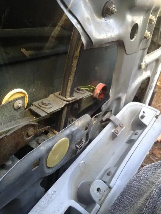

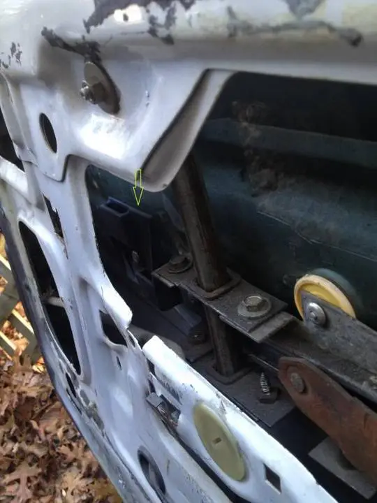

  1. On the passenger side, there are two half-dollar sized circles attached to the glass that hit the stoppers (L-brackets w/ 2 bolts) attached on the inside, top of the door. The drivers side has bigger (2"x2") plastic squares instead of the rubber circles. Did the original owner get the wrong but similar window from a donor car? (i.e. '88 Hatch or '87 Coupe) Can I use the goofy driver side door? What is the name for these parts? There are pics of the two DIFFERENT stoppers below.

Drivers side:
Passenger Side:

Could anyone give any insight on which type of glass "stopper" I should have on the drivers side door? (see pics)
