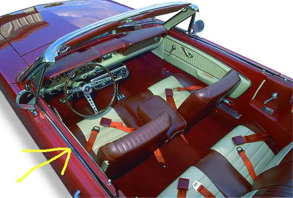

I am referring to the piece of rubber that is on the top edge of the door. It is the piece that would be touching the outside of the glass. I can't get my camera to upload pictures to my computer. I found this one online. I am referring to the outer window weather stripping.

Yeah, that's the window felt. IT could be new on both sides and would make it real tight if not put back on correctly. There are little "staples" that hold that felt on and if it is not installed tightly, it will bind your window. Remove the felt and try the window then. If it works without a problem, reinstall the felt "correctly" (tight to the door).
