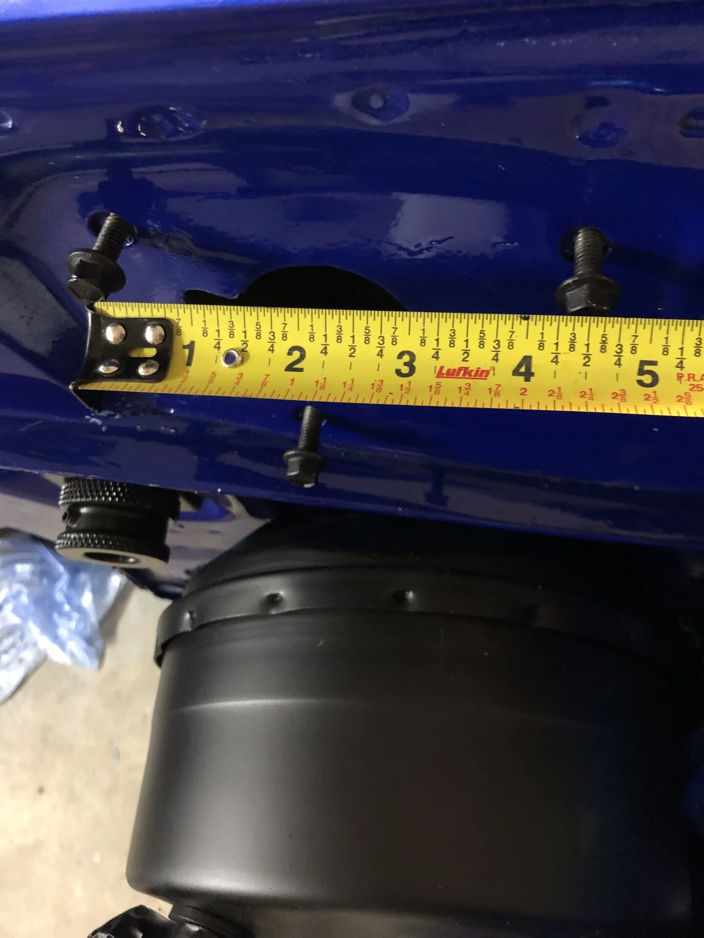

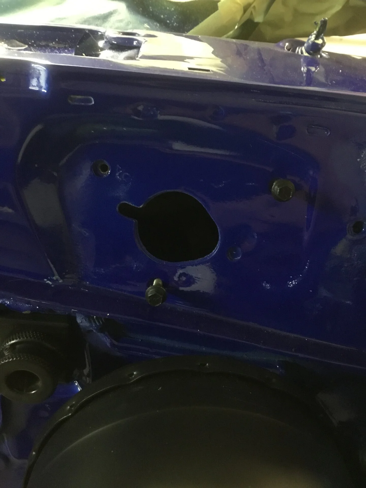

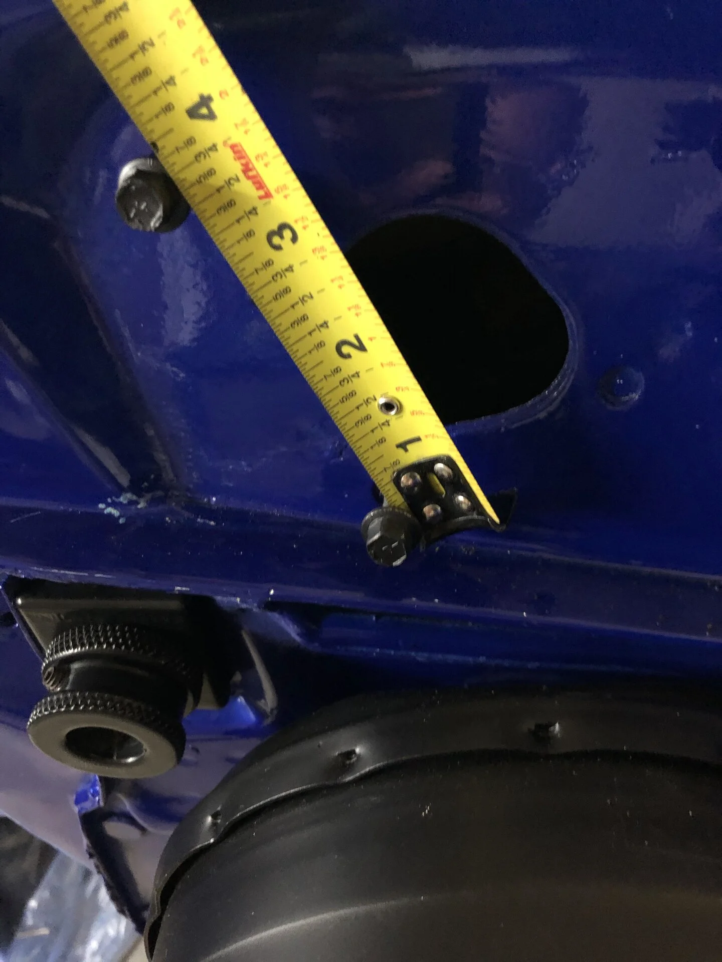

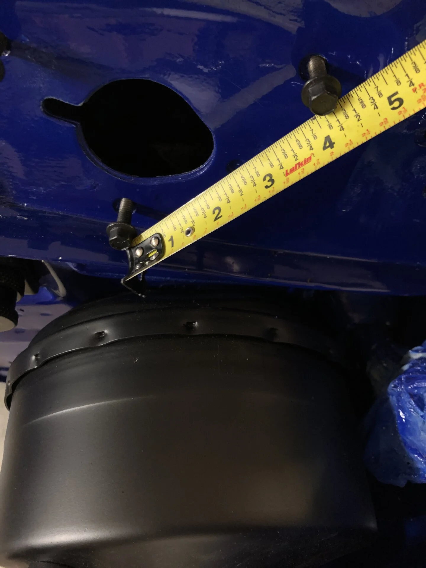

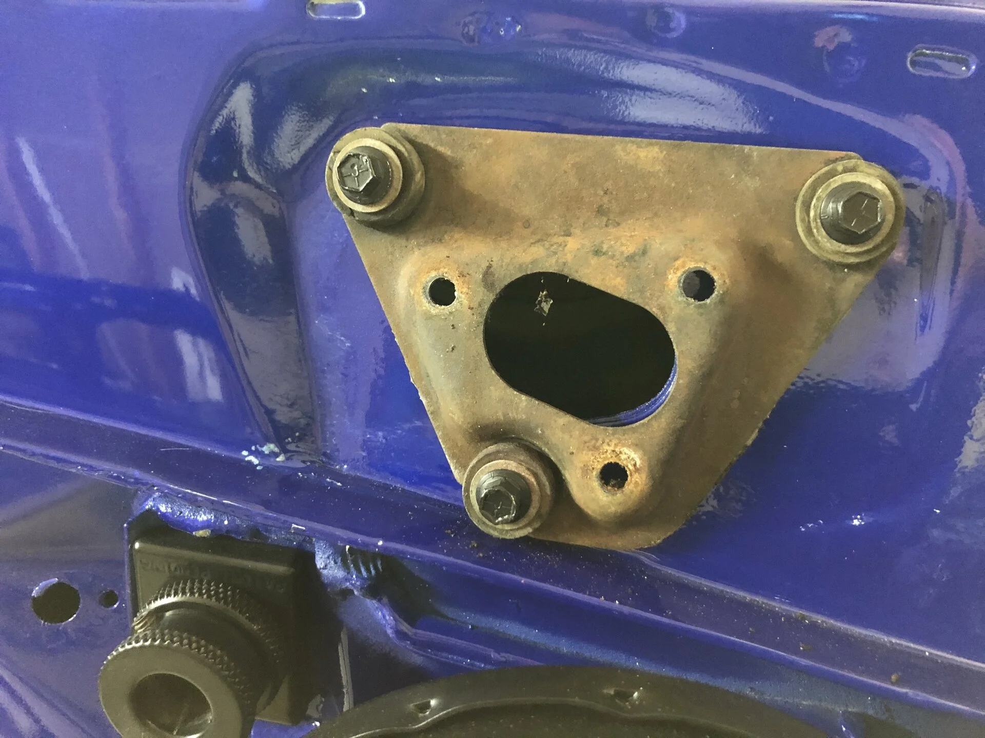

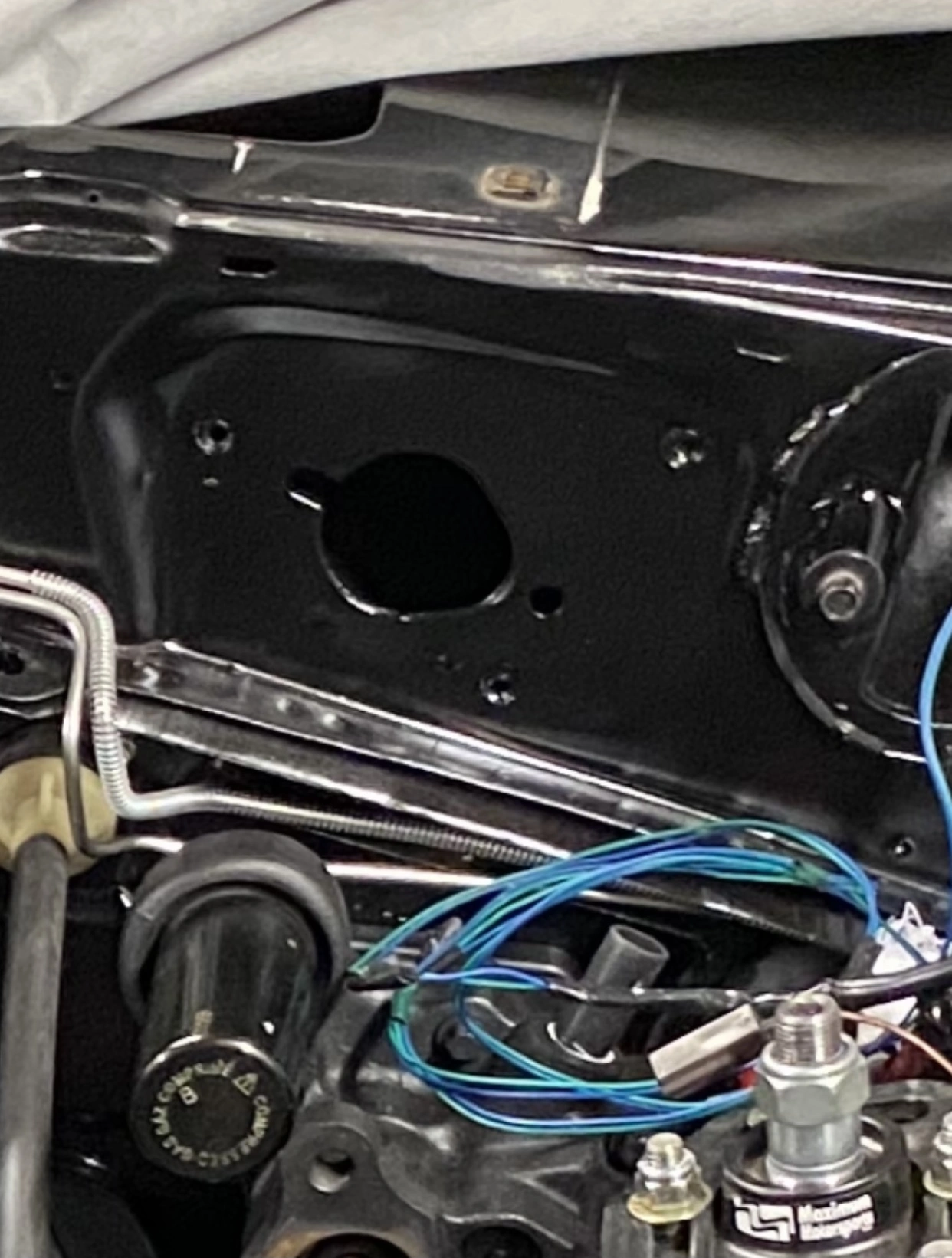

Ok got my motor today that was listed as a 93. Removed the mounting plate and it’s wrong. I am very confused.
the black circles are where the cowl is tapped and the little pen dots are where the mounting plate sit.
More

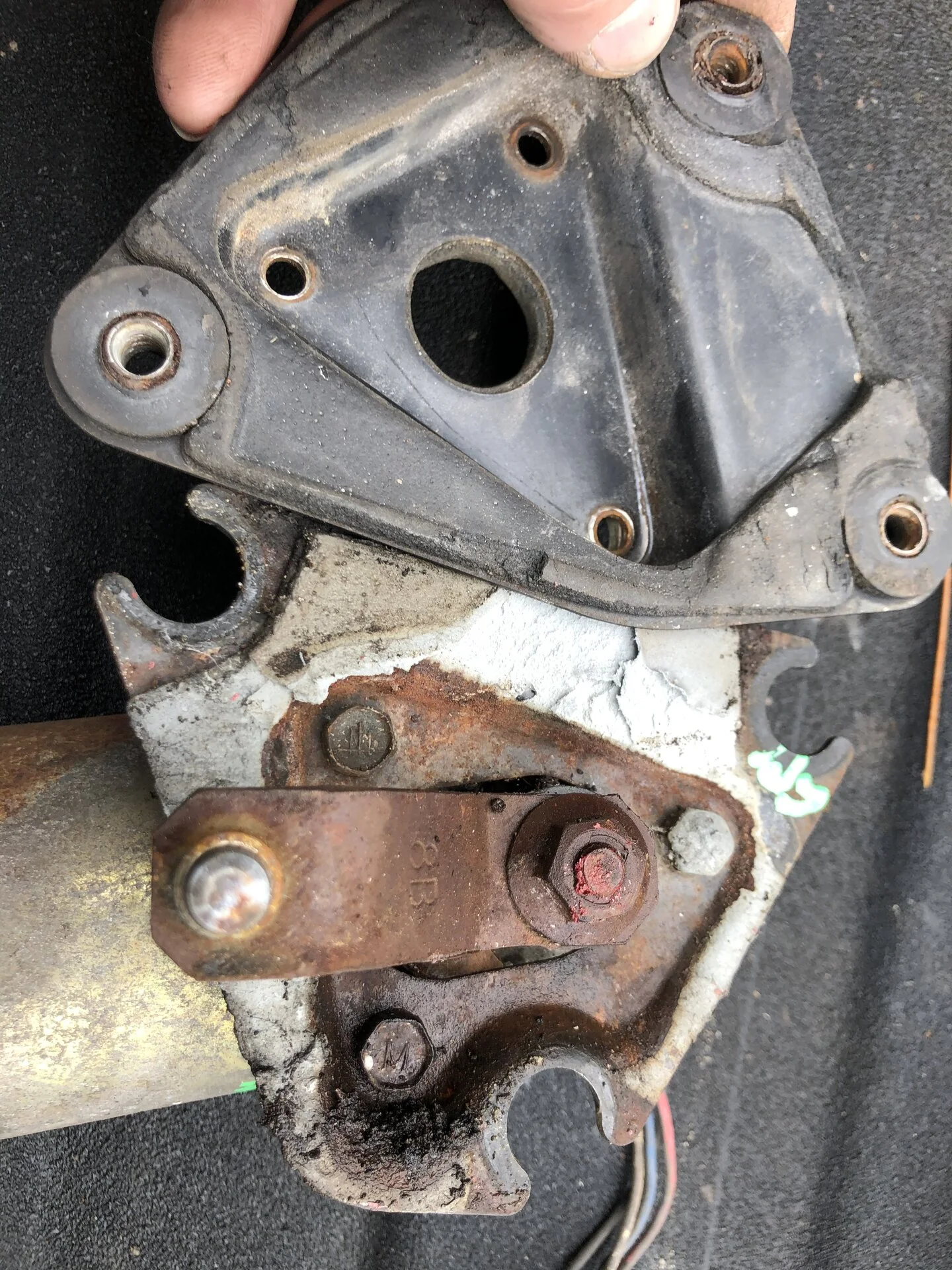

Crazy. Must have been replaced sometime before I got it. I did buy it from a friend that got it back in the mid 90’s. He says he never replaced the cowl but who knows Before he had it. There is a 85 motor on eBay for 100.00. I will try prestige tomorrow and see what they have. I hate to spend 100.00 and be wrong again.

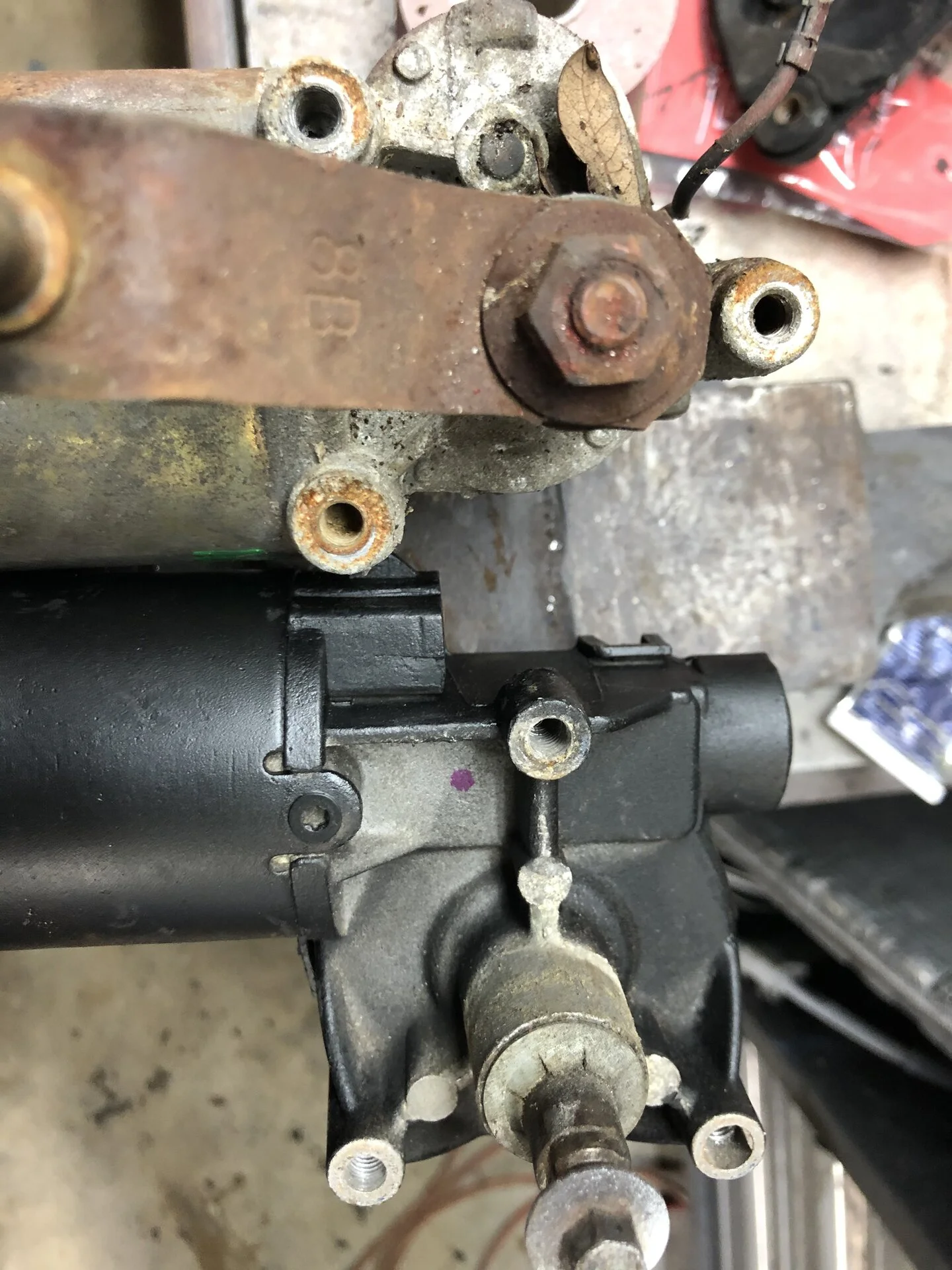

Ok so a local yard had a 84 . Jumped in the truck and went to get it. Definitely different. Will test fit before powdering

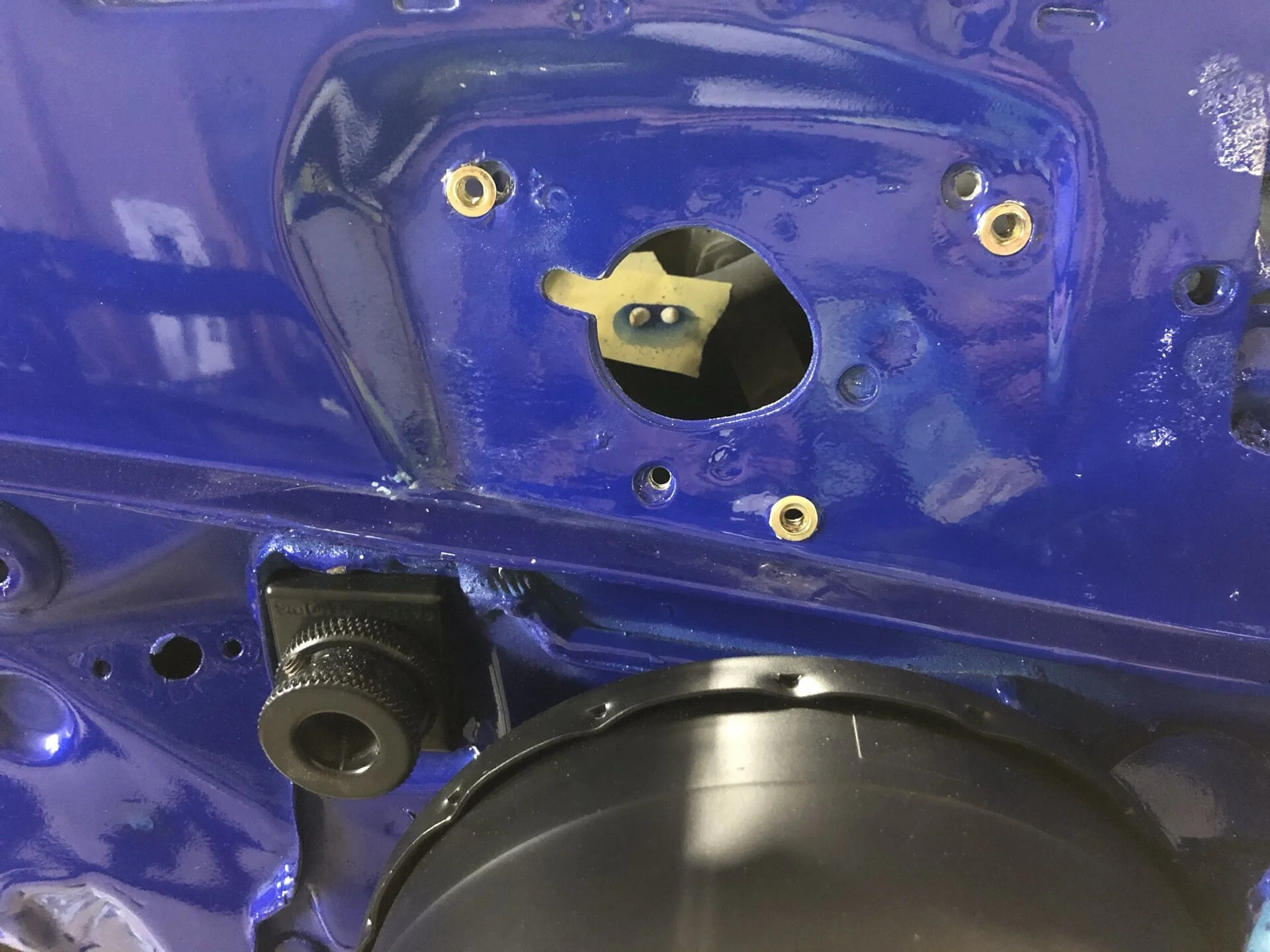

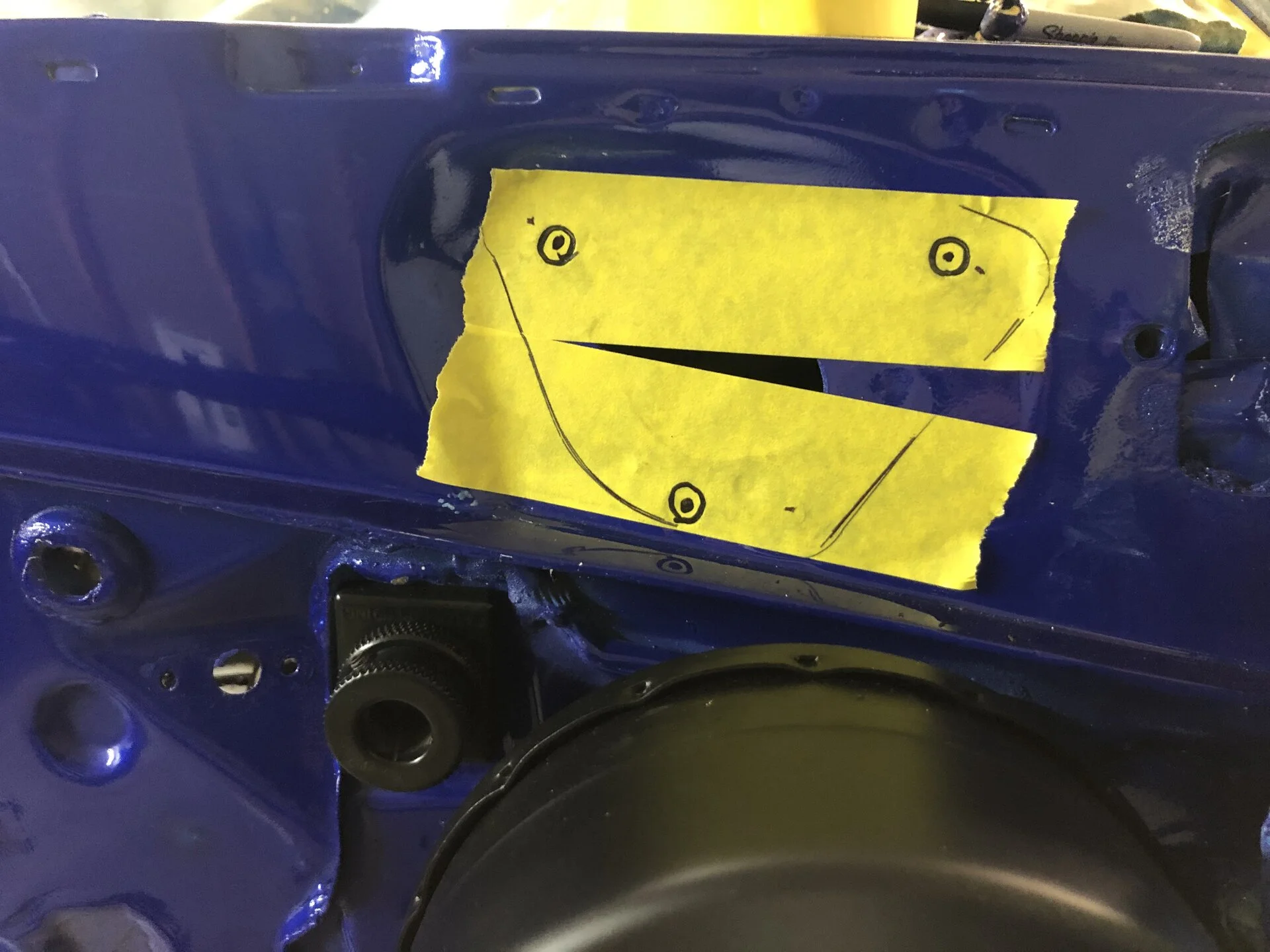

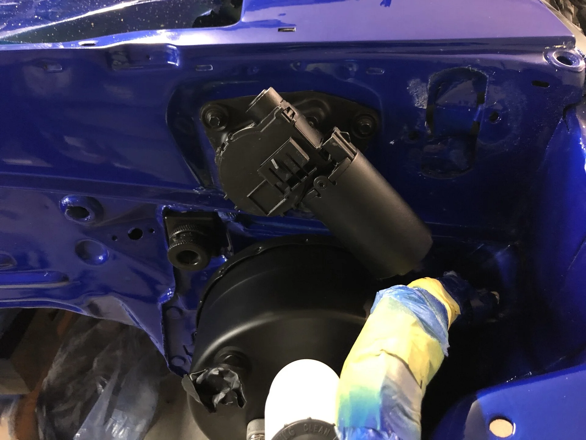

Well crap. Mounting bracket off a 84 fits the car. Unfortunately the 87 motor doesn’t fit the bracket. This is really frustrating. Guess I am going back to the 87 bracket just have to drill holes and use nutcerts don’t really see a way to put these together and it be any easier or cleaner looking.
