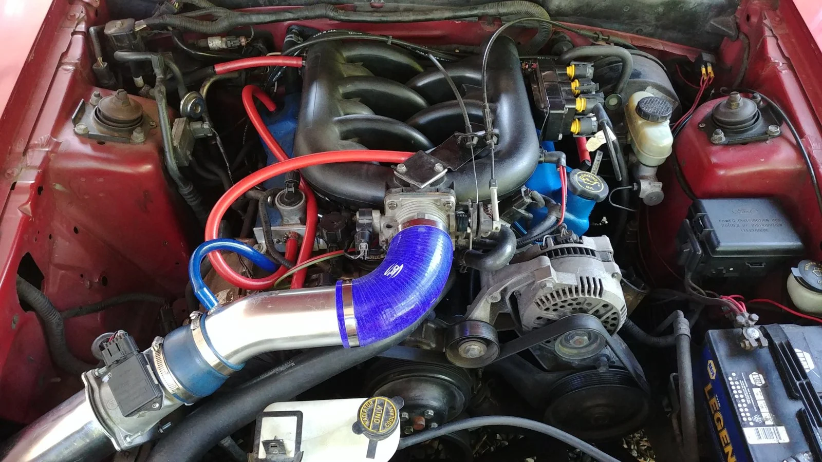

Hi folks, so I did a windstar swap on my '00 'Stang and now I'm experiencing issues. When the car is up to temp it has a rough idle and an intermittent popping sound(like decel burble) from the exhaust. I noticed it started sucking from the exhaust pipe like a burnt or stuck valve. I did the paper towel trick where you hold out a paper towel to the exhaust tip and it'll suck it in on certain exhaust pulses. It only does this when it's warm, not cold and wasn't present before the windstar swap. (Next is not as important as the aforementioned)The iac isn't working right either. On a cold start it'll fire up like it's warm, jumps to ~1300rpm and drops immediately to idle. When the ac compressor kicks in, the car almost dies, and in between shifts the rpms drop like a rock. I used 3/8in inside diameter hose to relocate it. Is that not big enough?

Well technically it is a windstar engine, since it's the same 3.8 as the mustangs, but no. It's the stock mustang engine with the windstar upper intake. The windstars had 200hp and the mustangs has 190hp, only difference is the upper intake.

Well yes, it was installed without a tune, but as soon as I finished I sent off for a revision for the intake. I only drove about 50 miles without a tune, it took them 4 days to get back. The only other thing to change is the throttle body, a 65mm throttle body from a 4.6

Tons of the windstar intake swap write ups on the forums say a tune isn't necessary for the swap, since the maf meters the extra air and compensates for it. I figured it'd be fine. Is there anyway to tell if it's running lean on these cars, short of an air/fuel meter?
