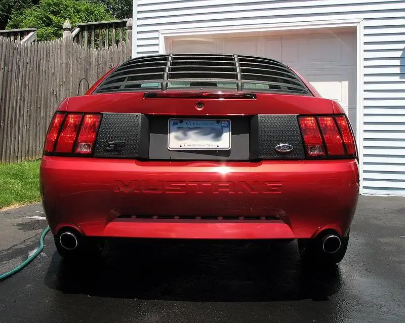

I love the look with out a wing:nice: . I took mine off last month just to see what it would look like and I love it. I will be getting the holes filled in and the trunk painted next year. Few pics of mine without a wing.
