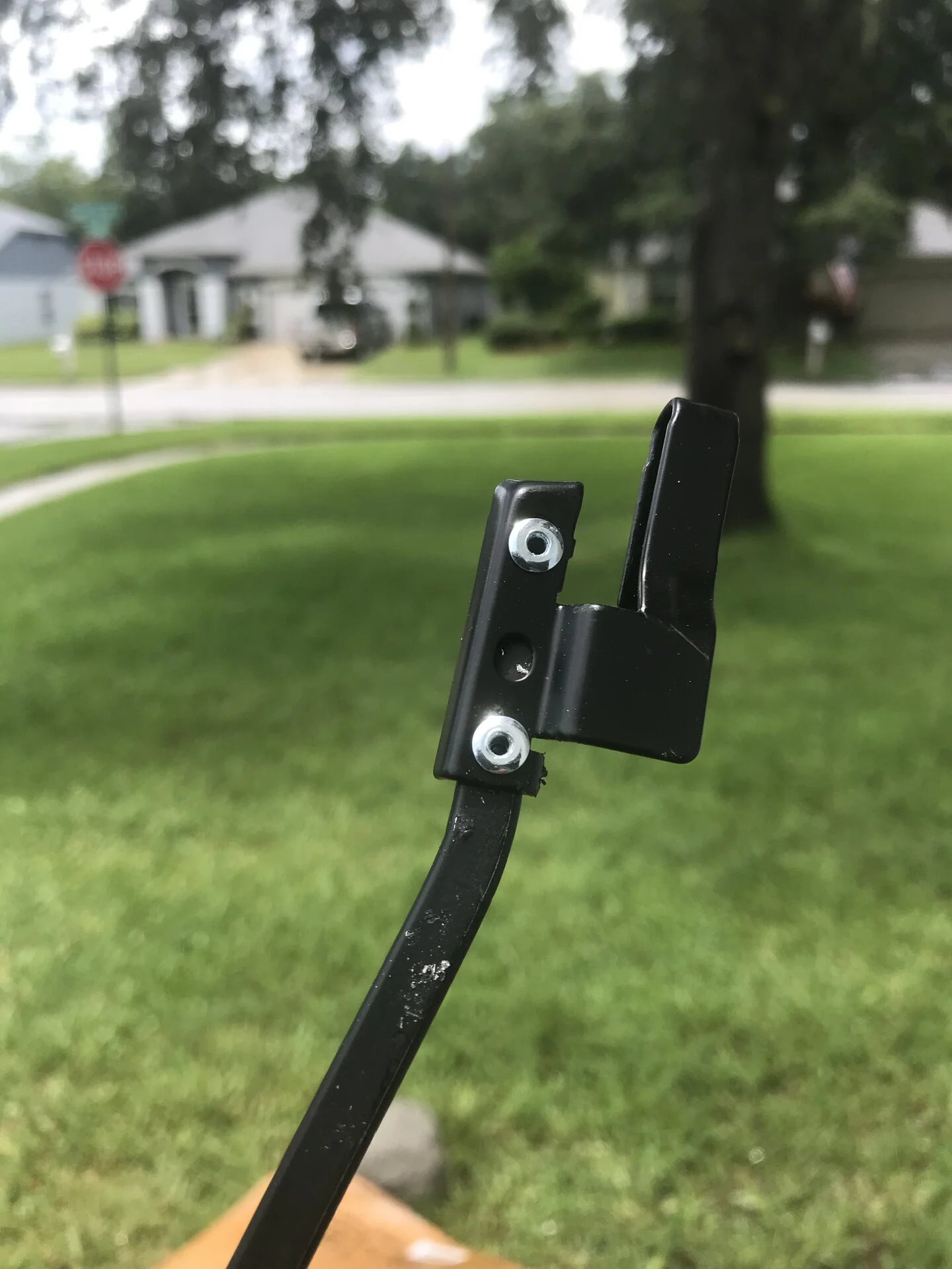

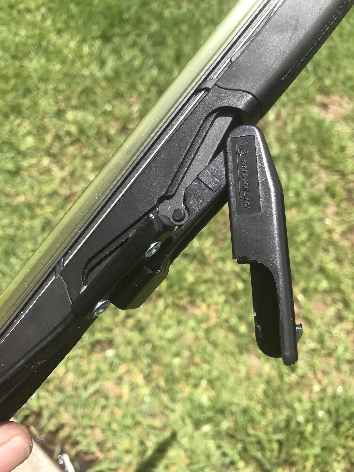

rotorhead22 Active Member Dec 17, 2020 175 89 38 Wesley Chapel, Florida Jul 2, 2021 #5 Jul 2, 2021 #5 LILCBRA said: I'm not sure if they'd work for the pin style as well, but I had to buy and install an adapter like this on my II wiper arms: Amazon product ASIN B07ZKL8LHPView: https://www.amazon.com/AUTOHAUX-Windshield-Adapter-Toyota-Mitsubishi/dp/B07ZKL8LHP/ref=sr_1_3?dchild=1&keywords=wiper+arm+adapter&qid=1622720528&sr=8-3 Click to expand... Worked like a charm. I had to use my favorite Ford tool the dremel to remove some plastic from the cover. I painted with some semi gloss black Attachments 09DBFF0F-3E1B-4C6B-8D4C-D2E8C4767820.webp 129.3 KB · Views: 128 BE903EAD-35E4-4DC6-BBC3-5DF05611720B.webp 294.4 KB · Views: 138 Reactions: LILCBRA
