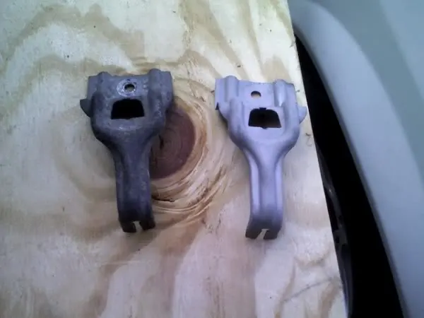

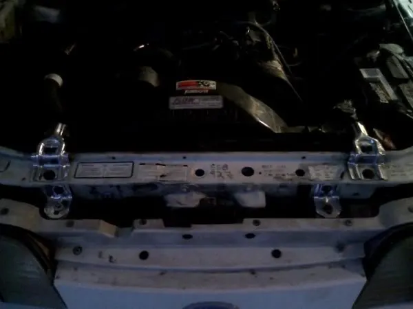

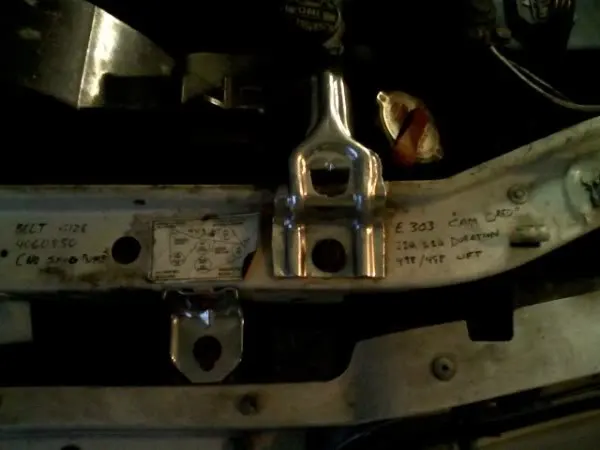

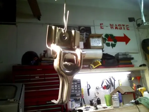

yeah they all seem to be rusty too :mad: i sandblasted mine, hand sanded it smooth, pre-baked it at 450 degrees, powder coated it in single stage chrome and then baked it again at 450 for 8 mins then 400 for another 20 mins. it took awhile but was worth it. heres some more pics of the radiator support brackets and bumper brackets i did today.

Those radiator brackets are a pain. I stripped mine down and used some high temp paint on them. It lasts for a while, but then something chips it and here we go again. The last time before a show. I masked around it and just sprayed it on the car, no time to dissasemble and reassemble. Don't worry, I had it entirely masked off around and underneath.

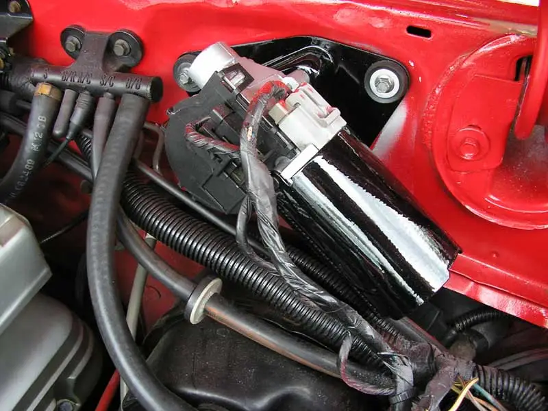

He might mean like what I did, chrome cover for the motor, and painted electrical housing. Tough to see in detail but you can see what i'm talking about:

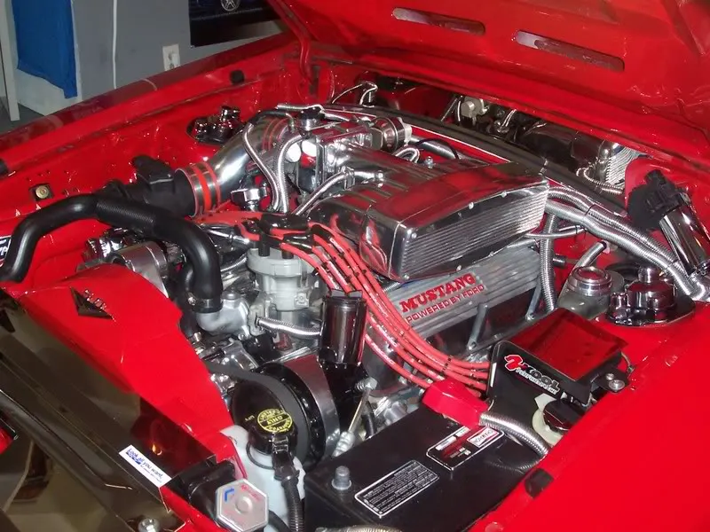

I would've chromed the mounting bracket I ended up painting but i figured w/the firewall mirror it would all just run together too much. I like the breakup in that area as I have it. But w/o the mirror I would've done it nice:

Cleaned the wiper motor and painted it...then installed a aftermarket chrome cover availble from 50resto....as you can see the motor is 'kept' incase it's needed but does not draw attention to itself while still fitting in with the 'theme' of the bay.
