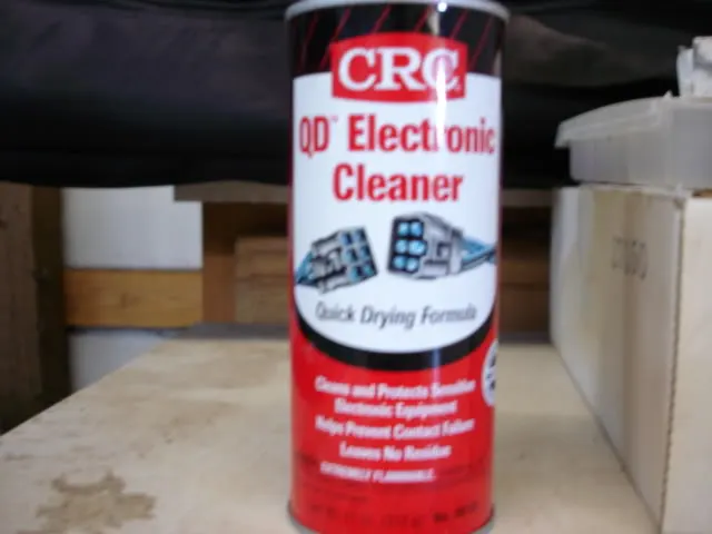

C R C CHEMICALS - CLEANER (11OZ ELECTRONIC CLNR)
Part No: 5102 = $4.49 at Oreillys.
I think Wally World has a bottle of it, but it's a pump spray type bottle (like Armorall is in). The pressurized can would probably be better in this situation.
Here's the stuff that I have used:
I think this is the same as what you mentioned Paul. The aerosol can will probably be better in this situation like you mentioned. I will get pics of the lever when I get home.

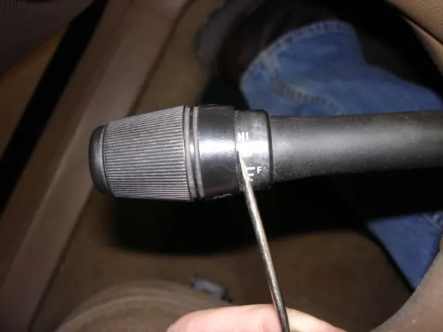

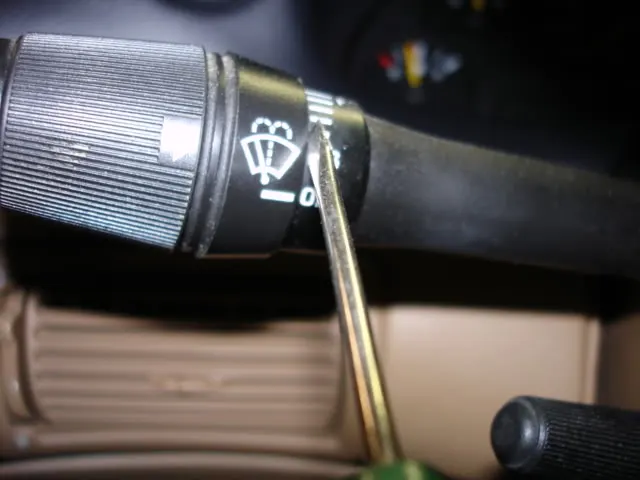

O.K. guys here are the pics.
You'll see a small gap on your lever where the knob rotates on it (my handy screwdriver is pointing to it). Try to push the knob up or to the side just a little bit to make the gap a little larger where you can see it and be able to spray the cleaner into there and then just follow the write-up. One more thing I just thought of....use some safety glasses/face shield/goggles when you are spraying that cleaner in close quarters. That stuff could fry your eyeballs pretty easily and better safe than sorry. Rather have rain on the windshield than fogged-up/non-functioning eyes. If you have any more questions, be sure to ask. I'll help you any way that I can. Hope this helps some of you out on the cheap. Good Luck!! :SNSign:
you are the man!!! thanks for the pics!!! I thought i would have to take it apart
