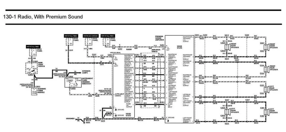

Im trying to figure out the positive and negative side of the speaker wires on my car for the 2 back speakers. It has the ford premium sound system in it and i just want to make sure i get my polarity right.
Thanks
This diagram is based on a 93. See if the colors match up.
