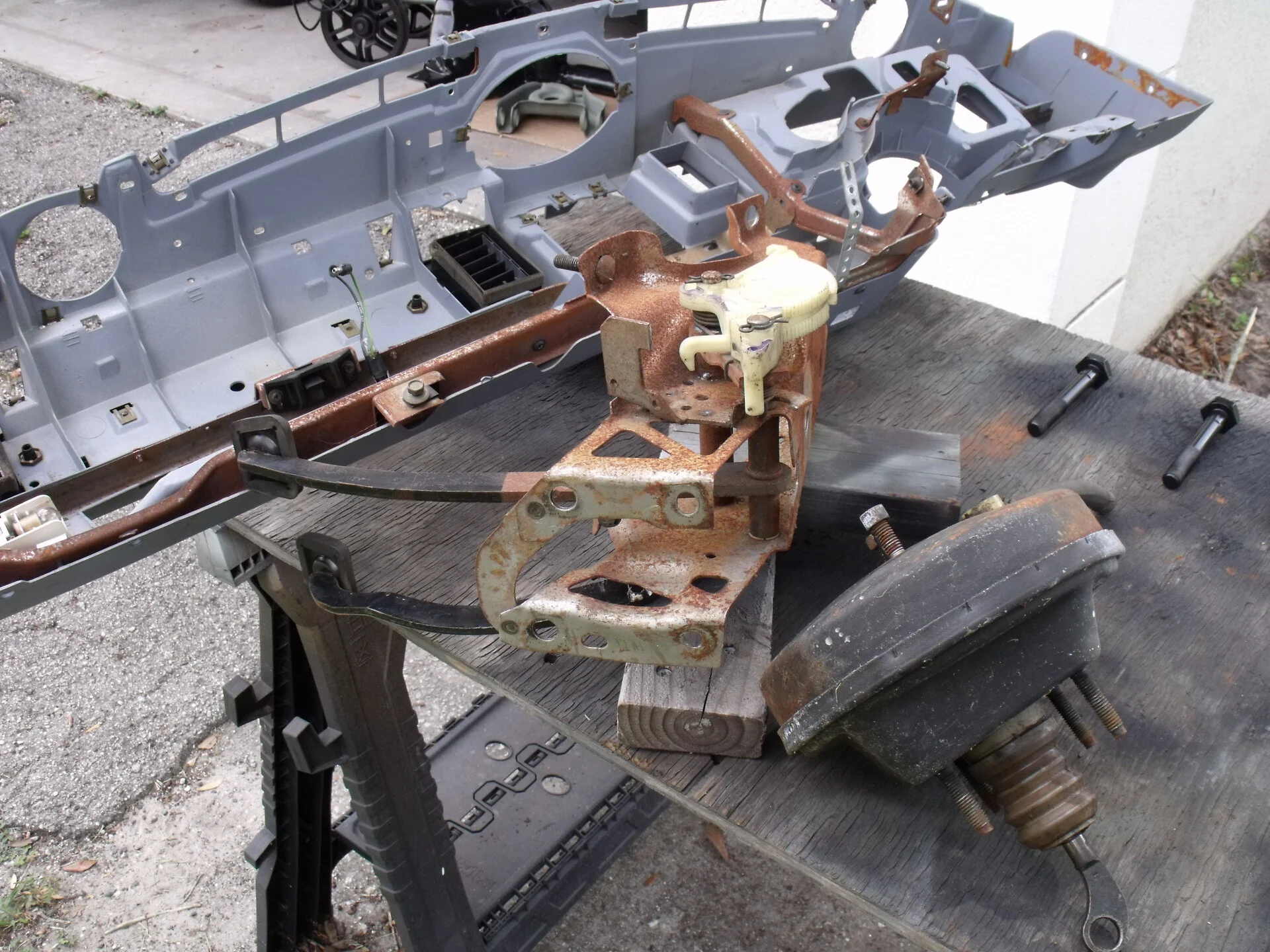

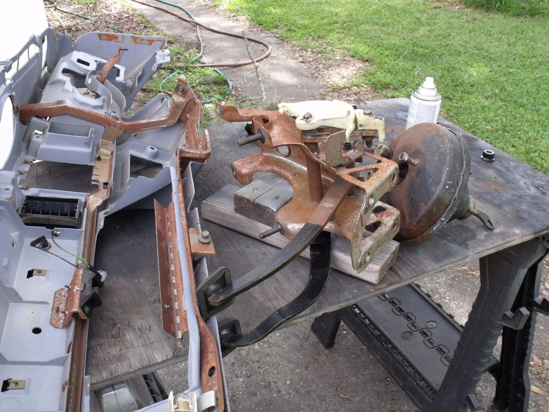

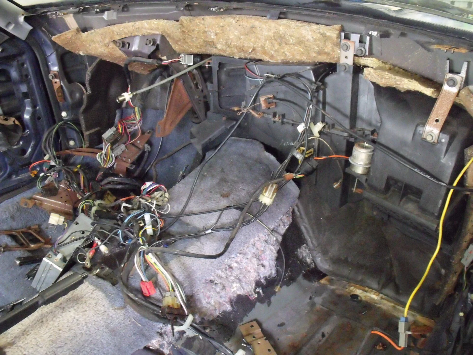

My goal for the day ( before it got to hot here in Florida) was to try and get the electrical connectors disconnected.....
Sheet man, I must of had my wheaties this morning....... Look what happened..
  • Wow
Reactions: Rdub6
