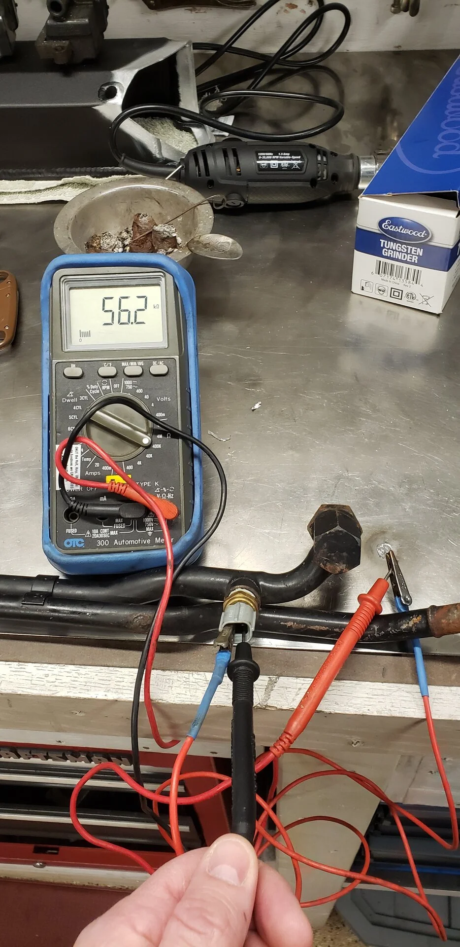

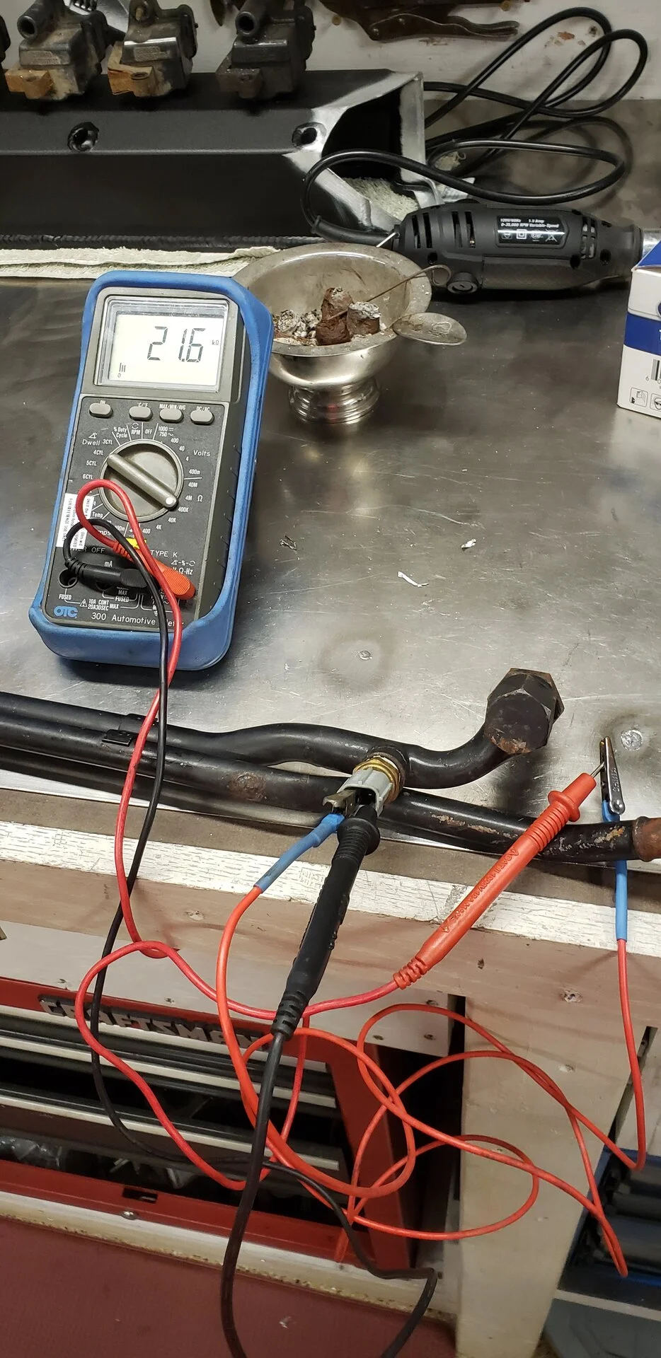

Hoytster said:
@Phdiesel
And just because I'm in a the mood to drive home how wrong you are because of the way you are addressing some very well known, knowledgeable, and respected members, here is a little real world test to drive the point home. Took my 2 minutes in my garage.
So here is the exact sensor you are talking about (2-wire, ECT temp sensor from a 5.0, Ford part # DY1145, 1984-1995 mustang). I measured this at room temp which is around 55 degrees in my garage.
Then I reversed the polarity of my test leads on my multimeter. Go figure, the exact same reading! (within measurement tolerance of course)
So then, according to your logic, if I would introduce some heat into the sensor and measure, I should get a drastically different reading when I reverse the polarity of my test leads? Right?
Reverse the test leads, and MAJIC! It reads about the same (sensor continued to soak some heat from the heat gun while I was getting the second measurement). But also notice how the resistance value went down, because it got hotter, just like a NTC thermistor should.
Around here, we treat our members with respect. You'll have to learn you can't assume the attitude of someone by the way you interpret their words online, otherwise you're going to have a really hard time on the internet in general. I have never seen any of those guys that responded to you put down anyone (that didn't absolutely deserve it). And after reading what you copied and posted, I can definitely tell you they were trying to help you and you took it the wrong way. Maybe take a step back and take a deep breath next time and try to approach it in a more civil way.

Hoytster said:
@Phdiesel
Ummmm, what a rant dude. You're not going to get much help around here acting like, but what the heck, let me try to help explain this to you.
BTW, what @Mustang5L5 said is absolutely correct, you can wire it either way. Since you seem to want specifics, it's technically called a NTC thermistor type sensor. A thermistor is a type of resistor. The Mustang ECU sends a 5v reference signal to the sensor and the resistance value through the sensor (depending on temp) causes a voltage to be sent out the other wire that is received by the ECU (just like the paragraph you circled). And you are correct, a NTC thermistor's resistance goes down as the temperature goes up. Also, as you can probably tell by the chart you are referencing, the resistance value is not linear to temperature change.
Here's the kicker, you can wire it either way because it's a thermistor (resistor) and will drop voltage either way. It doesn't care which way you wire it, it's a resistor and electricity can flow either way (no polarity). We're not talking about a diode here.
Look up "does it matter which way I wire a thermistor" and check yourself.
Edit, in fact, here ya go. Just click here and read.
Google Search "does it matter which way you wire a thermistor"

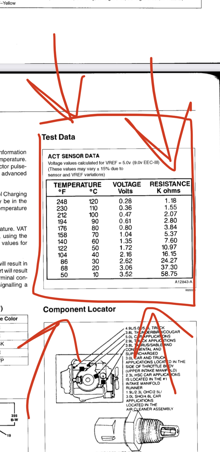

So, do any of you understand what this is saying??? Obviously not....

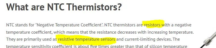

Phdiesel said:
Exactly, it’s a NTC sensor like I said... the moderator tried to tell me it wasn’t... how about you guys get it right before you start telling me I’m wrong??? It is in fact a NTC sensor... car closed... I am not wrong....
Go back and reread post #1, #2 and #3. What did I actually say before you rudely dismissed me with respect to the question that you originally asked right before the goal posts got moved??
NTC Thermistor = resistor.
NTC Thermistor
I love how your are actually using reference material I provided you and then proceeded to all over me in this thread. Glad you got your answer.

@Phdiesel
Calling the action of the sensor "NTC" was literally the only thing you got right. Everything else you rambled on about was wrong.
Phdiesel said:
That’s not true... geez... it’s not just a resistor... if you get it backwards the car will think it’s hot when it’s cold and cold when it’s hot and it will adjust fuel accordingly... Please stop wasting peoples time and stop answering questions you know nothing about...
It's literally a temperature sensitive resistor, so you're wrong. You can wire it either way and the ecu will get the correct reading, so you're wrong here again.
Phdiesel said:
It’s very clear that it’s a NTC sensor... it says so. And if you’re able to read that chart you sent youd see that it is as well... not arguing but you say it isn’t and the chart and paragraph actually says it is... sorry but, you guys are confused... “as temperature increases resistance decreases” that’s not “just a resistor” Because if you turn it around backwards you don’t get the same reading. Try it for yourself. But you didn’t help me out providing me with the schematic in which my problem is fixed... and for all of you that think I am wrong, go swap the wires on your sensor and come back and tell me your car doesn’t run like ....
Wrong again, same as above. I even showed you how you were wrong by using real world examples.
So you asked a question, a member answered it correctly, and then you decided you wanted to argue about whether it was a NTC thermistor or not while arguing the information he gave was false (when you were wrong). This is why you are alone on your island in this thread. Whether it was a NTC or PTC thermistor is moot, you were trying to argue incorrect information on the original question you asked. All while someone was trying to help you.
