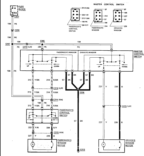

Hi
I would really need a Wiring diagram for
the power windows on a 85 GT
Thanks

Thanks Strype but I don't see anything for
an 85 .

I have already checked this site, but
don't see any diagram for power windows.

Odd that they show the power locks, but not the windows. I did notice that the schematics for the power locks are identical to the 88 schematics in layout and wire color. I'm not familiar with the 85 switch layout, but you might be able to get away with using 88 schematics for that circuit.

Here you go. Hope this helps
