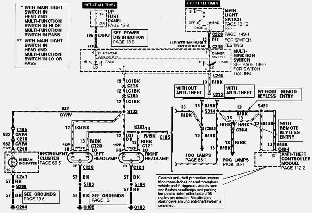

X xYoung347x New Member Nov 3, 2003 382 0 0 Jul 14, 2004 #1 Jul 14, 2004 #1 I need the Mustang Schmatic(sp?) so I can a short in my head lights.
R rockin_rick Member Oct 9, 2003 968 1 17 Jul 14, 2004 #2 Jul 14, 2004 #2 Hope this helps. Rick Attachments schematic 1994 headlights.webp 80.2 KB · Views: 124
