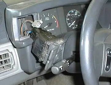

Ok, there are three main plugs on the wiring harness on the column.
I think I pulled the bigger Red with yellow stripe (headlight switch) and a smaller like 14 gauge orange with yellow stripe out of one of these three yesterday. I thought they were separate. I think I pulled it out of the top plug but now I'm not sure. This is a '90 GT. HELP! I want to start it again and not fry anything. These plugs fresh in anyones rebuilding/mods.

Anyone? I'm looking at my Chilton wiring diagram but it doesn't seem to help much. I think I've determined the Red with Yellow stripe wire is associated with the headlight switch and the Orange with yellow stripe goes to the hazard switch, but where the heck does it plug into the column wiring??? Certainly someone has one apart that can look.

Are these the ones? Found them on Corral.

Those are the ones going into the headlight and foglight switches on the dash. I need the other end where they end up in the column. If someone pulled their column cover you could probably see them. Is this corral.net or something? Maybe I can find what I need on their site.

VARRRRRRRRRRROOOOM!!!!! I got it!
Went by my friend's race Mustang who luckily still had his dash apart! Click. Click back where they are supposed to go and boom! Good as new!
Still a new flashing air bag light. That's next on the list, but she runs for now...that's good for me!
