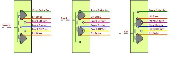

k the fuse box gives the switch power, and the brake lights power, but how does the switch control the brake lights... u know what i mean? But i'll look over it again.
What switch?
From the factory wiring, the brake lights get (battery power) from the headlight switch, then sends it to the brake light switch then to the signal light switch.
The signal switch determines whether current goes to both brake lights or when signaling, (Ignition power - when the key is on) current goes through the signal flasher unit to the left or right lamp which is the very same current path as the brake:
