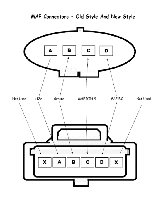

Wiring new MAF
Here you go...

Have you planned a custom tune or Tweeer tune to match the MAF to the computer? The 90 MM MAF's transfer curve will not match the computer's current program without some custom tuning.
