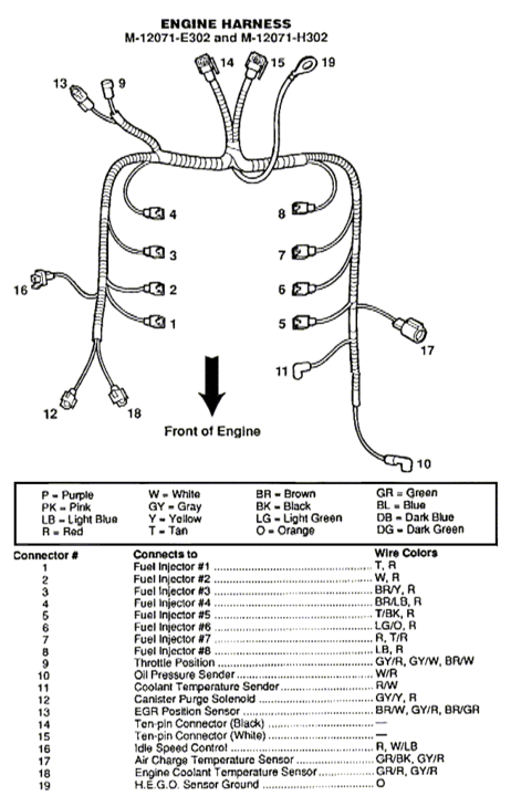

I recently got a 91 gt as a project. no motor or trans. it appeared to have the engine wire harrness but after i started takeing stuff apart i realize it wasn't in to good of shape. so i was wondering were would be the best place to get a new one. painless?? junkyard?? and it appeared the lights and windows, ect. were on a different harrness?? Thanks
They come up on ebay every now and then. I got mine from Ebay. There's 3 or 4 sections to it if I remember right. main section, injector harness, )2 harness and I think an a/c harness. In my opinion one from painless is more of a universal type. I don't think they are set up for emissions.
Fordfuelinjection.com used to make one too. I'm sure others will chime in with more information.
Engine EFI harness:
Main Chassis EFI Harness:
See the following website for some help from Tmoss (diagram designer) & Stang&2Birds (website host) for help on 88-95 wiring http://www.veryuseful.com/mustang/tech/engine/ Everyone should bookmark this site.
