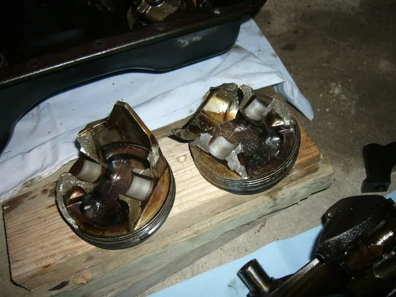

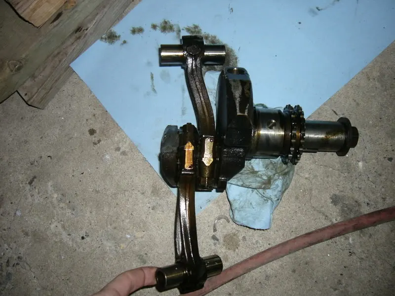

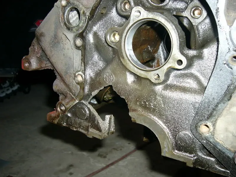

Photo proof of what happens when a balancer seperates at high RPM
