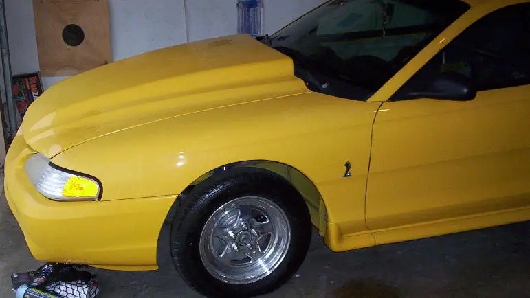

I have chance to buy a 90% complete race car it’s a 95 cobra clone w/ 8000 original miles on the body really good paint , tell me if this deal is to good to pass up also will a complete 306 with long tubs out of an 88 fox fit?

i cant post the pic's but its yellow and has no miles put on it since it was put together

I don't know....7k is a lot for a roller. Your 88 motor will fit but the exhaust is probably no good. You could probably do all that stuff to your fox for 7k and not have to do any fabbing. I had a project like that earlier this year and I sold one coupe to buy another....I wish that I had never done it.
Those don't look like 8k mile headlights -- first thing I noticed.
Usually buying a car like that would be a major headache -- but there are occasions where someone is just looking to unload it, so you might get lucky. :shrug:
i have all the prices he paid just in parts alone it comes to over 13K for just the parts thats not including labor or the cost of the car or to install all the parts and set up the fule system all the lines are run, The car has never run like it is all the part are new
