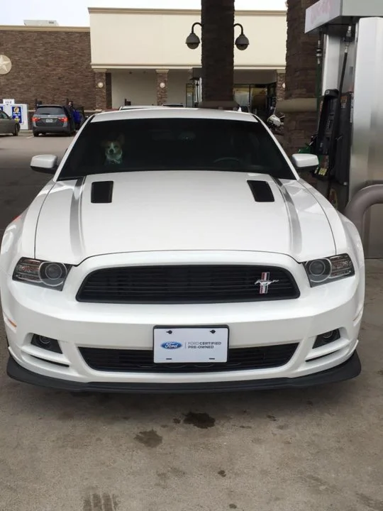

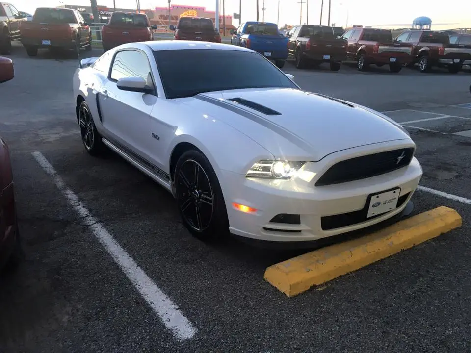

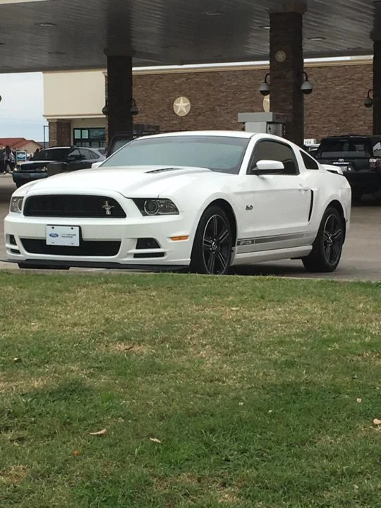

Well, I picked up the "new" car last night. 2013 GT/CS; 6-spd manual, 7,394 miles.. Completely bone stock. Absolutely love this thing!!

Sweet Fawkn ride bro!!.. I think you def upgraded just a lil bit haha. Congrats brotha and happy it got resolved so quickly and they did rite by you bro! Sweet ride again!.. I might have to barrow it sumtime lol haha. Take care of her and watch out for idiots on the road. Man i'm super happy and that's just freakin awesome everything about the new ride!! Take care and you know what time it is rite??.. Modding time!! Keep us posted brotha : ) Think i'm feeling full x-haust longtubes, x-pipe, and i know for those coyote motors anything by Pypes $400-$600, Flowmaster $700-$900, Roush ?, MBRP $400-$600, Bassani $800-$1000 Stainless works can be kinda $ but i have seen online for between $650-$800 and that Catback sounds sweet as well sounds fawkin narley!! Couple of my buddies have the 11-14 5.0's and i know Ford Racing, JBA (I love JBA X-haust stuff but they are major $1100-1500ish.... These are for the FULL Catback kit/systems, NOT just the Axelback muffler kits ( I can never really tell huge difference over stock by going with just the Axelback kits ( swapping mufflers GAY! ) it's def worth the xtra $300-$600 to get the FULL Catback kit!! Just a heads up checkout Latemodelrestoration.com they have really good deals on everything better than Americanmuscle.com. AM used too be reasonable but in the last couple years they have spiked $'s big time!.. Latemodel has a JBA catback kit for $679, MBRP Catbacks in the $500's depending on what finish you want, etc.. Lemme know! :)

Thanks!! I would like to (at some point) throw on some gears, headers/x-pipe, and springs but it'll be a while. Right now I'm living off a grad student stipend & it's got a 10-year/100k mile warranty, so it'll be a while before it gets any mods on it.
