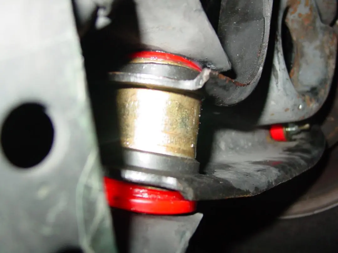

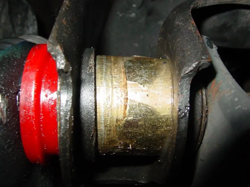

On another note, I noticed that the front control bushings didn't look right. The bushings that I had installed are red and normally you can see the red polyurethane on both ends of the bushing insert. Well, on the driver's side control arm, you couldn't see the red on one of the ends. I went over to my mechanic and we were able to slide the control arms on the bushing. The original ones were pretty worn. I don't know if that will solve the problem but I definitely don't think that those control arms should slide on the bushings. I am going to try and upload pics of it. I had to take them in weird angles cause I barely fit under there. The second pic shows the passenger side which looks fine but still slides a bit.
thats why i wont use them,,the frame mount sway bar bushings do that too,,they have them for ford twin ibeam also,used on radis arm for more caster..fords powersteerings leak bad and i have learned it eats them up fast,,they all look nice but i perfer stock bushing anyday...something else i have noticed with poly-bushings..you feel everthing..they are stiff..hope thats your problem
