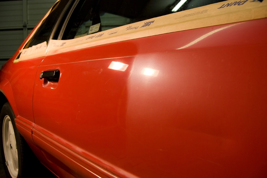

WTF have I done? Notch pics..

spent a few hours on it again. got alot of it done i guess, but it is a real bitch. i had 2 clay bars from a meguires kit, those are both shot. so i got a new turtle wax kit. the clay bar itself is much better. clay is firmer so it seems to hold shape/clean better.
i have this remaining; lower sections of car under trim, cowl squares, passenger door and a small section of passenger fender. im also going to re-do my roof again. anyways, ill upload some pics i took in a dark light. it looks pretty damn good..

yeah i hear you.. im oprah exhausted and its not done still :(
tomorrow i should get it done. atleast get all the claying done then just wax it saturday. im not after anything spectacular. it's gotta be way better then it was even if i left it at this point.
