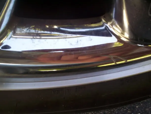

Be very cautious .... that could be the copper plating under the chrome starting to come through. Prior to chrome plating a piece they will copper plate it so the chrome has something to stick to. If the chrome isn't very thick then the copper will start to show after sometime. Using a polishing material will only remove the little chrome that is left on the wheel, thereby exposing the copper plating. Do you have a pic of the wheel?

What year is it? The newer ones (I think 2003 and up) are just wheel covers (essentially really nice hub caps). They have had some problems with the chrome on them because it is a plastic wheel cover, copper plated, and then chromed. My dad got his replaced under warranty. If it is prior to 2003 then it will be an actual wheel (no cover) that is polished.

CORRECT! It is a wheel cover, take your finger nail and run it accross the back of one of the spokes just at the edge (where the front meets the back) You wheel see what he is talking about. It is a wheel cover that almost looks like a wheel!

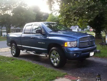

Ok guys well here is an attempt for pictures, hard to take pics with a reflection. Let me know what you think, I guess I can take it in if its covered by warranty. By the way it is a 2005.
