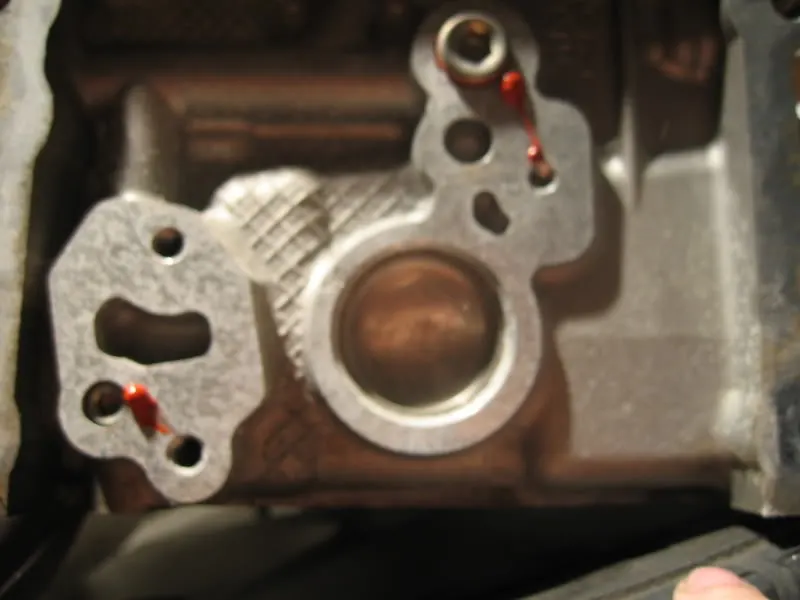

took a look at the stock heads and found this......On the rear of my stockers I had two Plug looking things..... I put a red dot next to each one...The front of my stockers only has the larger one, the smaller being absent.
These are both the plugs that need to be changed?

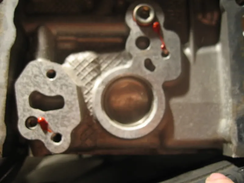

Yes, match the after market heads to your stock ones. Remove each of the plugs and install them into the same holes.
Patriot should have told you they were or werent installed.

no those ones in the front are for the timing tensioner
you have to put them in the rear because the heads are universal and you can put them on either side so after you
put plugs in back your good to go front ones need to be left out to control timing tensioner
the large plug must be installed on both ends of the head,the little plug that is not in the front of the left head is install in the same galley just on the surface of the head,all plugs must be present
