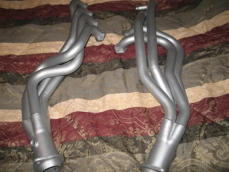

Ok, the guy I bought the car from said it had Mac headers when I bought it, but I've bought 2 different X-pipes this year and neither fit. I bought a BBK X first (before I knew there was a difference in headers, pls don't flame me lol) and then a Dr. Gas.
Every body told me go with Dr. Gas so I finally tried it, and guess what? It wasn't even close. :mad: :mad: My headers measure 18" center to center at the collectors. Anybody wanna share their measurements or give me some insight?? The Dr. Gas X is 13-14" at the header collectors...I'm bout ready to say screw it till I can by new headers too

every h or x pipe ive ever installed had to be modified a bit to fit, ussually just had to tweak it out till it fit. Im not recommending this since I dont know other peoples experiences but ive installed 3 so far on 3 different cars and every one of them have needed that done...
Well BBK uses a solid flange design and Mac uses individual flanges. Here are my Macs

Since stock are 21 1/2" center to center those are big differences. However, don't the H-pipes have an adjustable connection at the "H"? I'm certain my BBK O/R H pipe did.
H-pipes for short tube headers have an adjustable center. It's really not an adjustment though, so much as a place the pipe can come apart to make it more compact for shipping. Long tube h-pipes are small enough that they don't need to come apart for shipping.

yeah, those are just like my headers...and I know I'm gonna have to modify any X-pipe I buy, but I expected it to be closer than that. I'd havta spend another $200 just to get it to fit :notnice:
