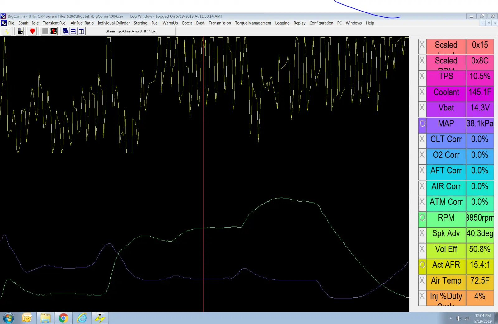

Check out this 10 second data log. The
Peak to trough AFR is ~13 to 9.3. I think this may be the bottom of the scale for BS3's sensor. I checked all but plugs 7 & 8, and so far they looked good. I tried idling it in the driveway and pulling each injector's connector 1 at a time. It didn't make an immediate difference, but then it may be so saturated in fuel it'll take a bit to burn it off. I dunno.
If it were a fouled plug, I would expect to see that cylinder read lean, not rich. My only guess is an open injector. I honestly had no idea until I connected the computer for the first time in a while that this was even happening. At low engine speed, I could feel what felt like a miss, but it wasn't consistent, and I just figured that the engine didn't like load at low rpm.
Do you have any ideas?

Well, this is disturbing. It wasn't an injector. I just replaced the whole set and am still getting this issue. Ignore the blue line at the top... just made a mistake copying the pic. Anyways, here's an interesting (to me) observation: Higher revs make no difference in the rate of the AFR fluctuation. I wondered if it might be a valve issue. So, I left the MAP on, but as you can see, nothing funny going on there.
I was so confident that in injector was going to be the issue. I guess that's what I get for thinking. Damn. I don't know what to do next. My best guess is that it's in the tune. I'm gonna have to go back to the drawing board, because this is unacceptable.

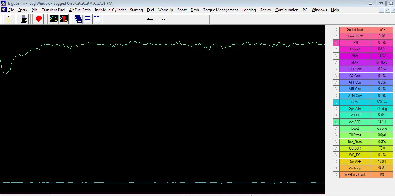

Much better!
627488
Bad O2 sensor. I looked around for something like that, before I ordered the injectors, but couldn't find any O2s that failed like that. The lack of change at various RPM gave it away. I'm debating whether I should put the old injectors back on to keep the new injectors fresh.
