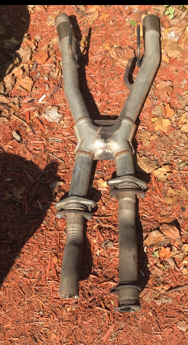

I would like to get a bit more sound out of my 91 - I have a BBK X pipe for long tubes - was thinking to cut my orig back 2 cats off and weld this on - it has air tube inlet but no O2 sensor holes - will car run ok if these sensors are removed ? Or should I just cut the back cats off and keep orig piping and just use less of the X pipe?

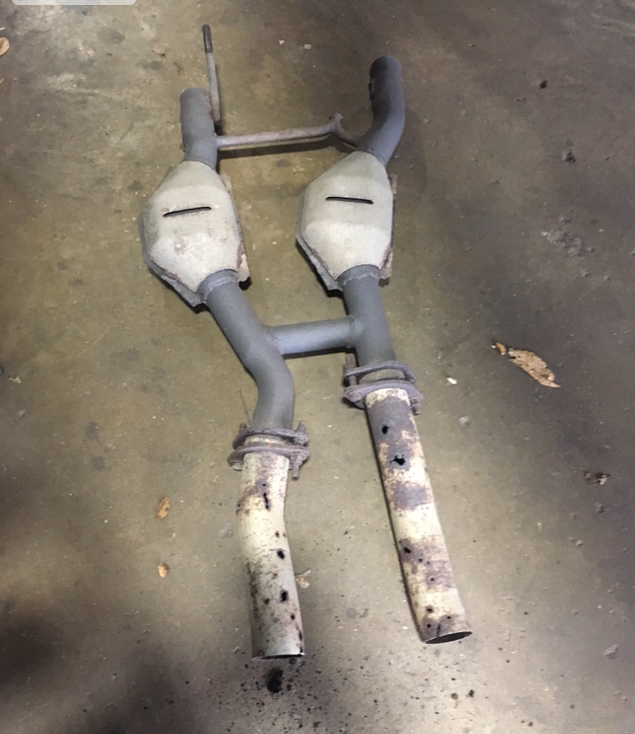

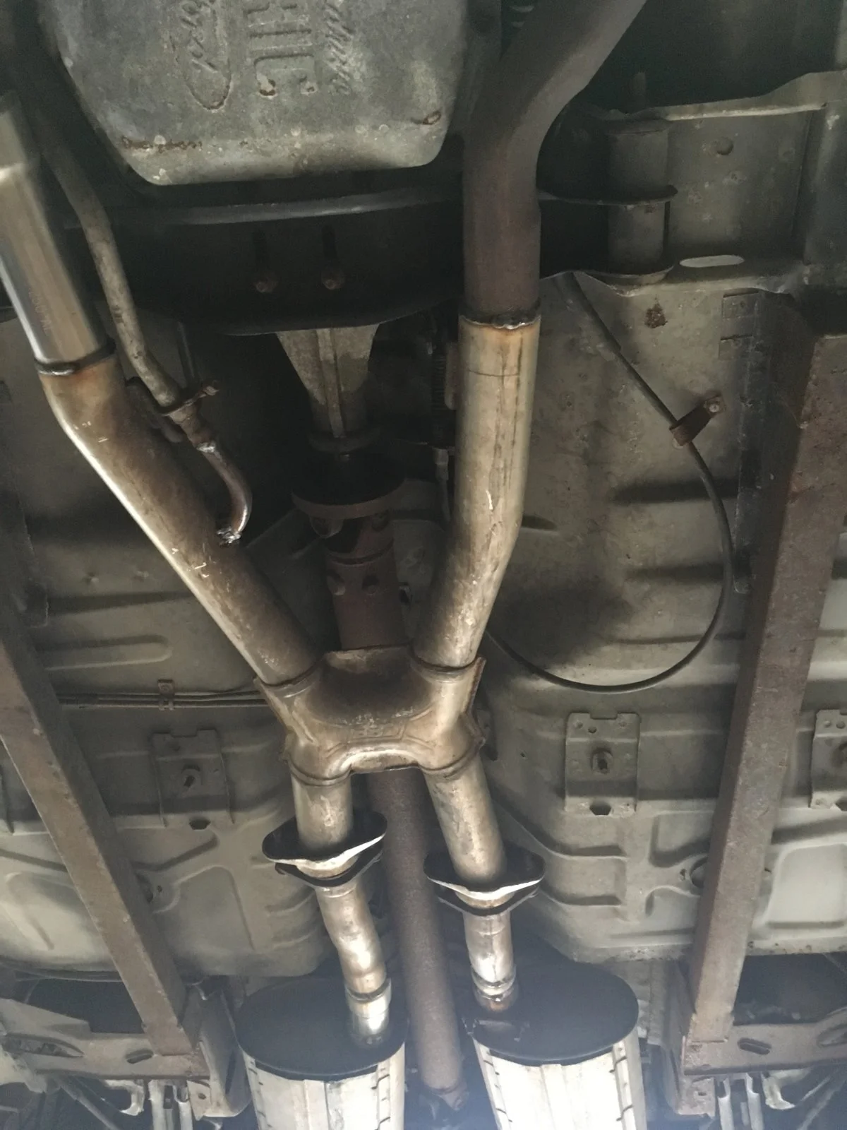

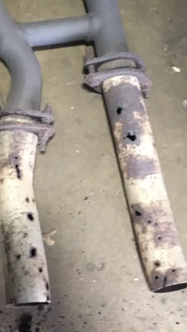

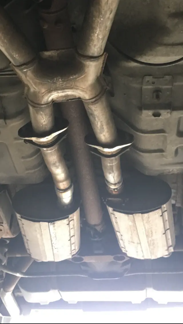

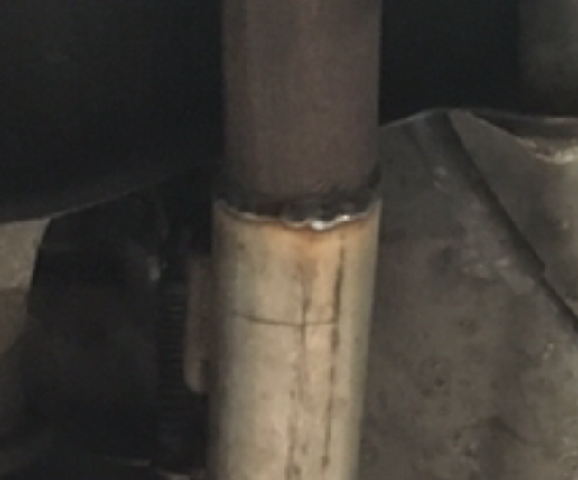

Cut off old H pipe area and got the X fully welded on the car - old pipe had rusted holes and a broken hanger ( causing it to bounce ) there were no o2 sensors in this area , just the air tube ( hook that up too ) car sounds a bit quieter but lower rumble tone ( I like it ! ) probably was higher noise from the rust holes - $100 labor well spent !

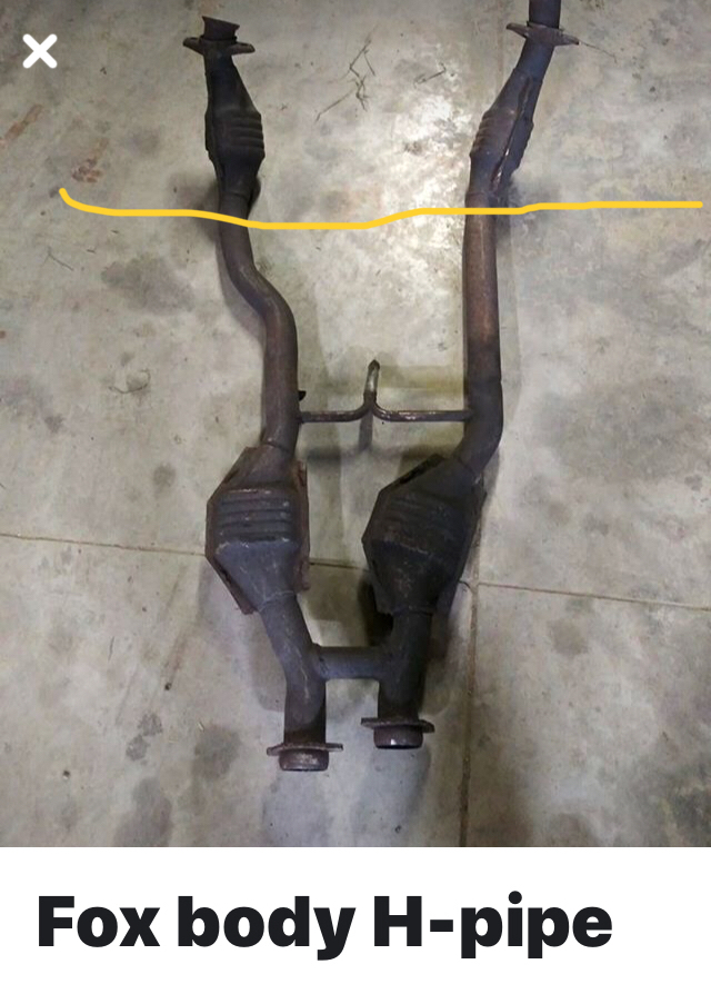

There are O2s on it right? I'm guessing they are further up on the exhaust and just not in the pic?

The O2s are mounted up ahead of where the pre-cats would be. First couple inches of the H-pipe. There are no rear o2's on a fox.

From what I read from people who cut both front and rear cats off and looked inside them - they look like the same honeycomb - they said these are 4 cat systems - btw I sold back 2 cats for $80 scrap guy ( I had no idea they are valuable )

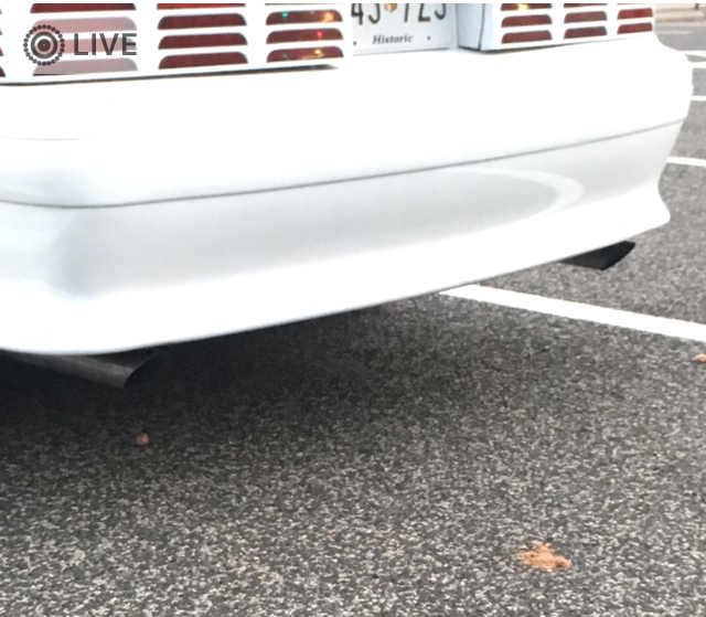

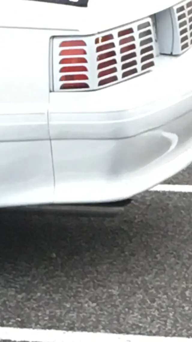

Tucked the LX pipes under bumper

The more I drive the car with X pipe , the more I like it ! Feels like a power boost when rpms hit 2500 - sound is not much different ( maybe a bit louder , but same rumble ) I have no idea what mufflers are on it , lol -

Aren't those heat shields supposed to be facing up?

Might have heat plates on otherside also ?
