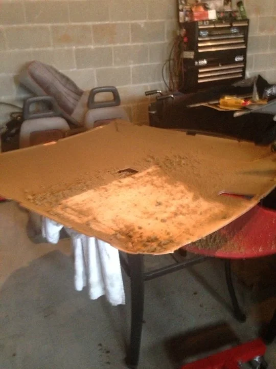

I replaced one on my 2nd stang, still have it its a parts car now, headliner is still sticking. I got the fabric from a fabric shop and glued it in with spray adhesive. Use a putty knife or something flat to scrape all the loose foam off. Spray the adhesive to the fabric and the cardboard insert. Let it sit as long as it says on bottle, I think till it gets tacky. Then start on one side and roll it on to air pockets down. let it set up and your good to go. It would have been around 1998 when I did mine on a 86 4cyl

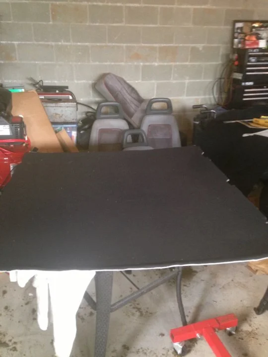

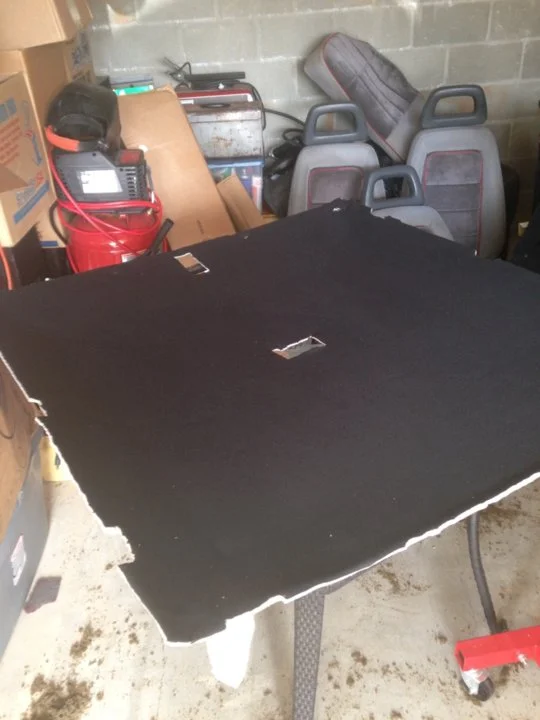

I replaced mine.
Pulled the original liner off the board. Went to fabric shop and got some black fabric for $5.
Went to Home Depot and got a can of 3M spray adhesive. (Super 77)
Sprayed the board and stuck the fabric to it and let it dry. They trimmed the fabric up and left a little hanging off the edgers and installed like oem.
Cost me under $20

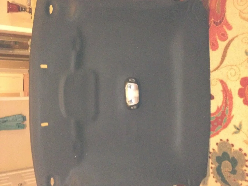

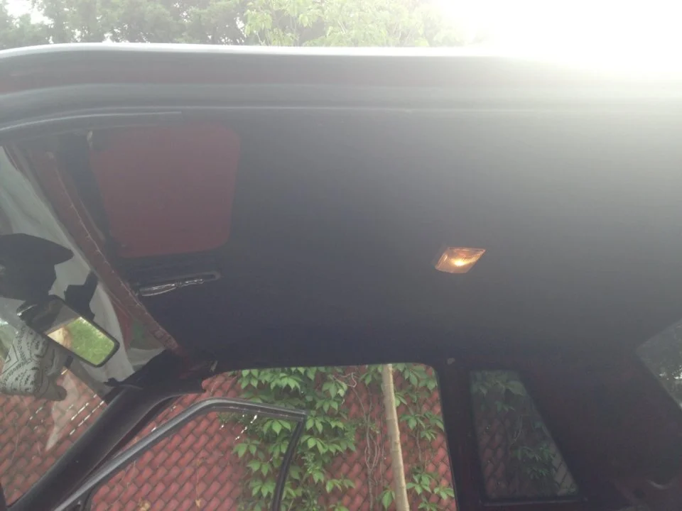

I detailed that but apparently we both mis read his post . he was just wondering what held the board up
