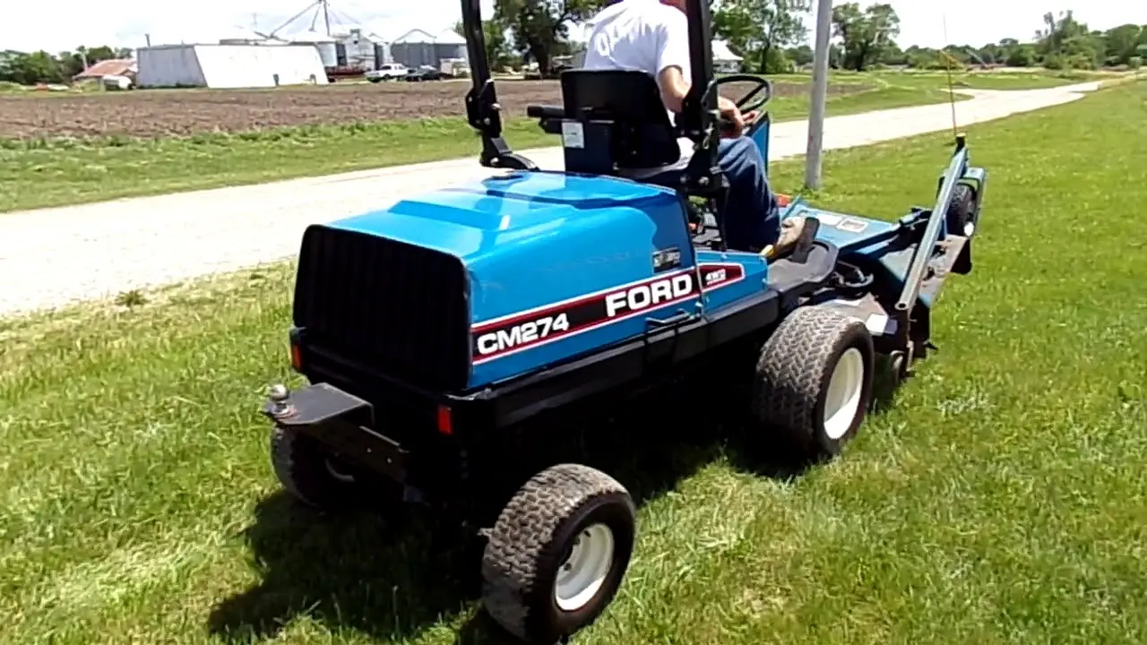

I've got a Ford CM-274 with this diesel in it and lately, it's been having an issue where the throttle just falls off. The thing nearly stalls and then it'll recover.
I've put an in-line fuel pressure gauge between the filter and injector assy, and I'm reading [zero]. Very odd that it runs just fine at other times :shrug:

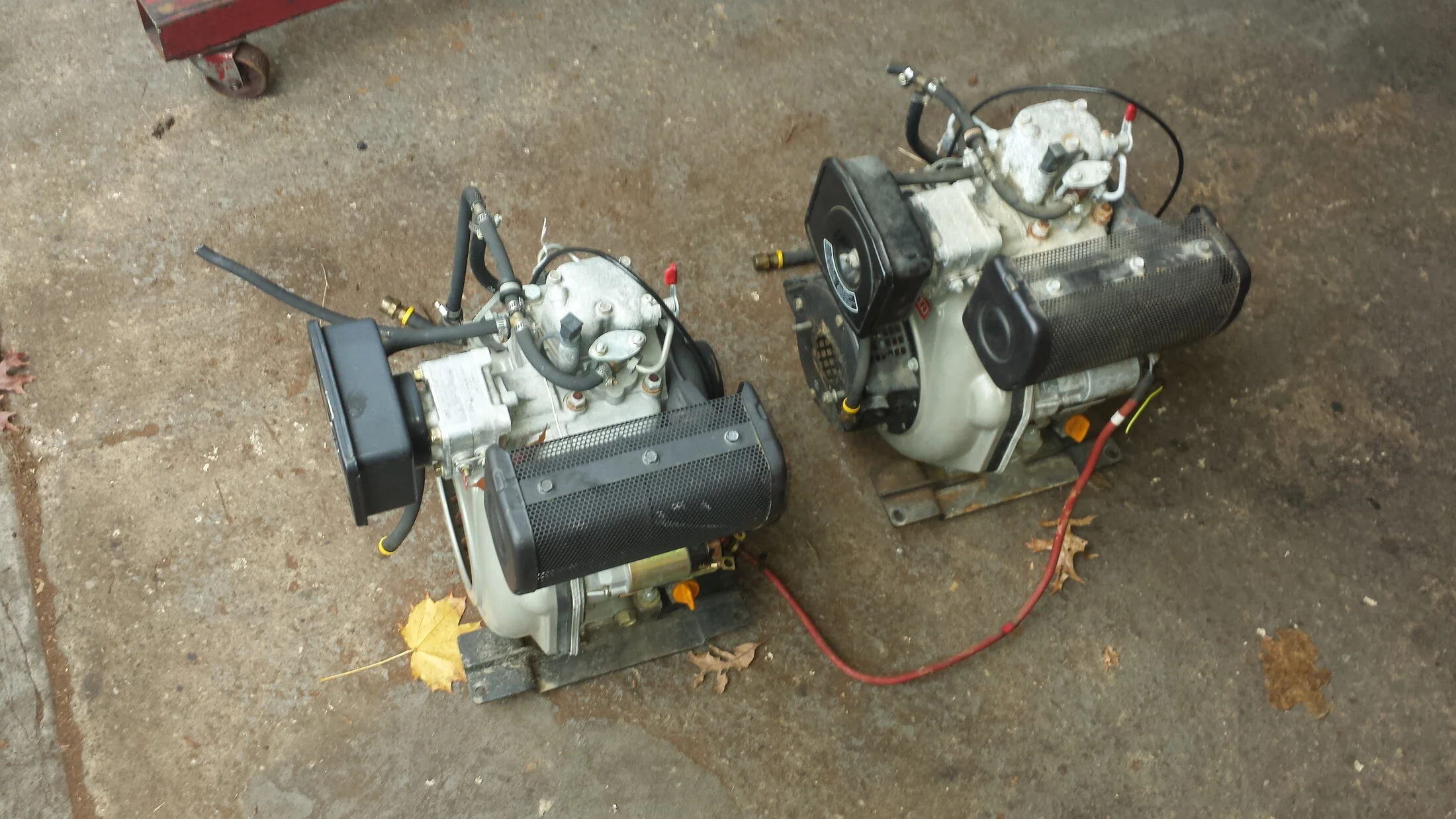

Im more familiar with the 7-10hp single cylinder types but have some friends that have hd bad luck with their 3 cyl gennies and the problems are attributed to the middle cylinder kicking a headgasket due to a warped engine block when casted..

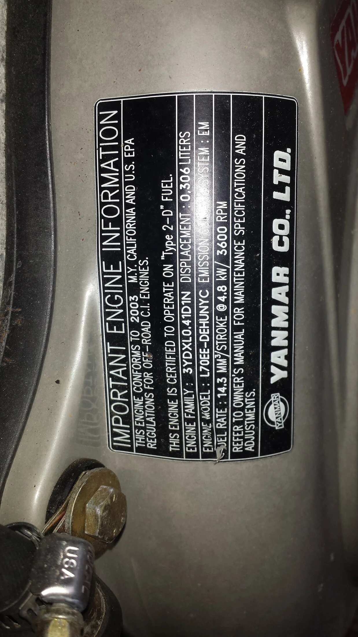

According to the manual the pressure should be 422 psi at the mechanical and 6-8psi at the electric lift pump..

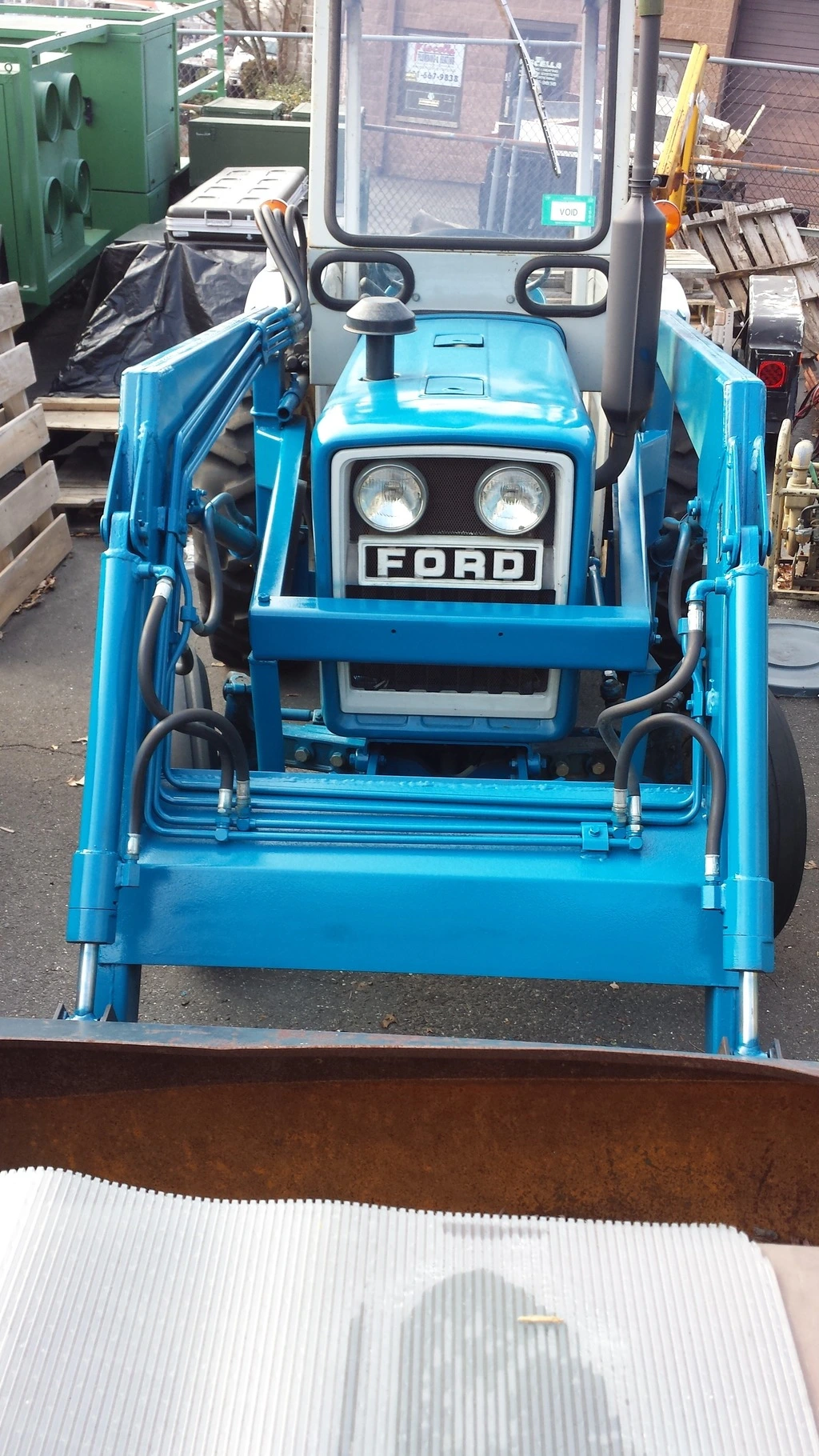

As far as the tractor itself it should of been dealer prepped and tuned....

My Ford tractor has a gas 4 cylinder in it...LOL
