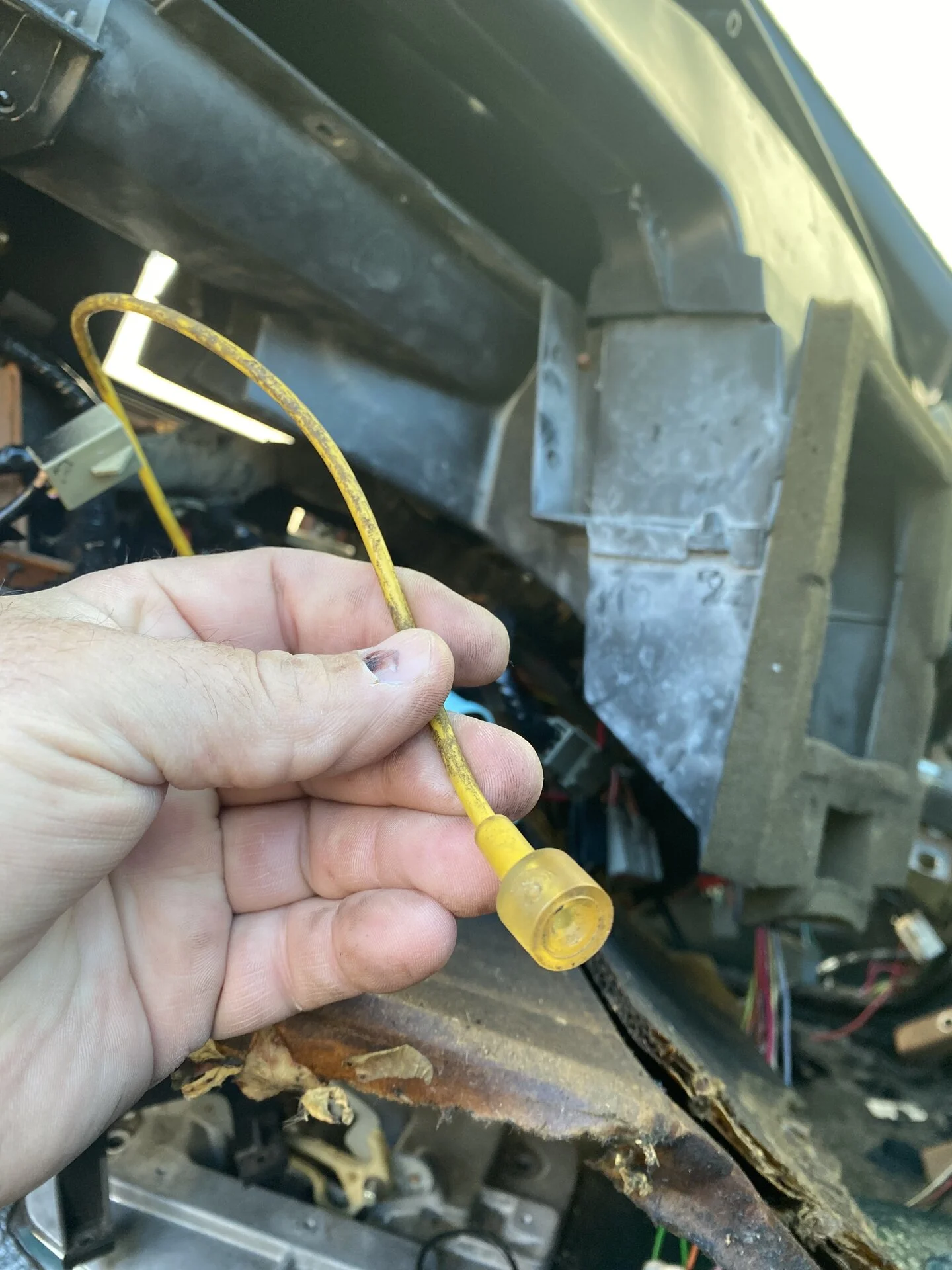

B Blueinfan Active Member Mar 18, 2021 259 60 38 Temecula Dec 18, 2021 #1 Dec 18, 2021 #1 Hi All, Trying to figure out where this vacuum line goes. I have looked n can’t find a connection for it Attachments 1AF6A7E0-563E-40F3-906B-FA608CD0B1BB.webp 191.8 KB · Views: 468
Mustang5L5 That is…until I whipped out my Bissell Mod Dude Feb 18, 2001 43,299 18,005 224 Massachusetts Dec 18, 2021 #2 Dec 18, 2021 #2 Drivers side of the HVAC center stack there is a vaccum canister that moved the center flap that controls air to the defrost.. there’s a port on the vac canister and the yellow line connects there Reactions: Blueinfan and General karthief
Mstng93SSP You have a nice rear end there Dave. 15 Year Member Nov 29, 1999 2,993 3,500 184 Mililani, Hawaii Dec 18, 2021 #3 Dec 18, 2021 #3 And if I remember correctly it's a pretty good reach up in there to hook it up. Reactions: Blueinfan
