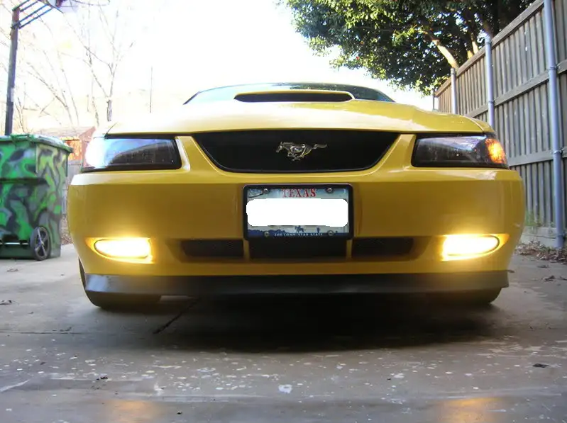

I tinted my fogs yellow for a different look............
[/IMG]
how did you go about doing that?
i would have just gotten some lumics yellow bulbs
+1
Diamond clear housings and Luminics 2500K bulbs.
The stock fogs blow, they offer no light output. They really need a clear lens.
I have luminics in my G35. Really helped with vision in inclimate weather. Then again, the fog lights on my G35 are brighter than the headlights on my Mustang.
Yeah I looked for yellow replacement bulbs but couldnt find any. The Luminics
web site says they are N.A. Thats how I got the idea of just tinting them.
Actually It was just an experiment that turned out better than I thought.
I already had smoked vinyl overlays so I bought a $2.50 roll of yellow transparent
lens repair tape. I stuck the tape to a piece of flat glass, then stuck the
smoked overlay on the tape and used an exacto knife to carefully cut out
the shape. Then I just skweegeed the tape on the lens (no bubbles)
By the way the vinyl over lays had kept the lens in "virgin condition" But really
I would like to get the yellow bulbs since they would put out some useable light.
check here
I went ahead and bought some 893 JDM yellow 37.5 W fog bulbs.
They are not Luminics, they are Top Speed. Anyone heard of them?
They are brighter for sure but are still not much help in fog conditions......
We had a really foggy morning last week. Also they arnt as yellow as I
wanted. What do you think.......

i tinted my fogs on my car yellow too prob like a yr ago but i used stain glass spray on them and have a 5o watt bulb.muchhhh brighter and you determine how yellow you want them by the number og coats.just did my SHO fogs too.makes a big diff if you have HID Hheadlights
