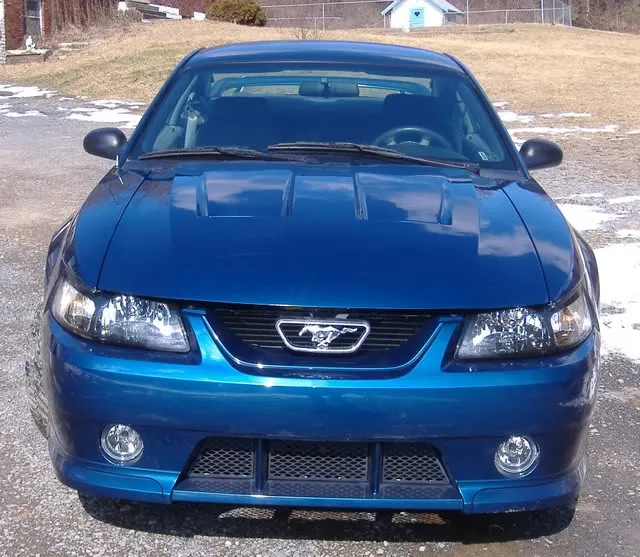

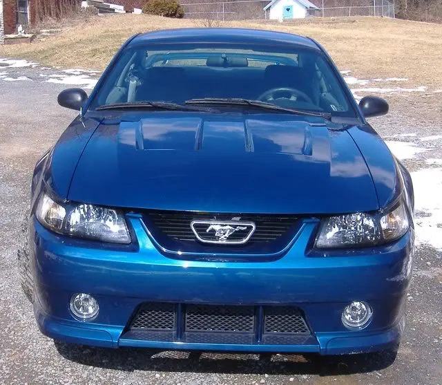

yep, shes home..PICS..
the hoods are exactly the same if i recall.
whatever is wrong with the gap is something to do with the bumper or headlight header panel. somethings definately tweaked, there should be no reason the bumper does that. something is either wrong or something needs to be modified to make it work. maybe some spacers and pull the bumper top supports up and back about an inch.

03/04 cobra hoods were slightly shorter and the bumper was a little bit taller where it connects under the hood
My freind has an origional 03/04 Cobra hood on his GT and there is no gap. Fits like a glove.
My freind had a wrecked 98 and it had the gap just like that also after it was fixed, except your hood looks like its also sitting a taaad high on the front.
Either way, it looks sick man. Definatly a change for the better, the gaps can be taken care of.
whatever is wrong with the gap is something to do with the bumper or headlight header panel. somethings definitely tweaked, there should be no reason the bumper does that. something is either wrong or something needs to be modified to make it work. maybe some spacers and pull the bumper top supports up and back about an inch.
Agreed.
Neither of my ROUSH Cobras looked like that ..... the delete kit may help that.
Otherwise, of course I like it at least the pics I can see.
:nice:

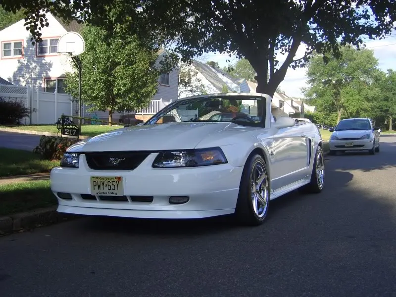

The gap is natural with a 03 cobra hood and GT/Rousch bumper. But honestly Ray, I think something might be missing there. My gap doesn't seem to be that bad:
:shrug:

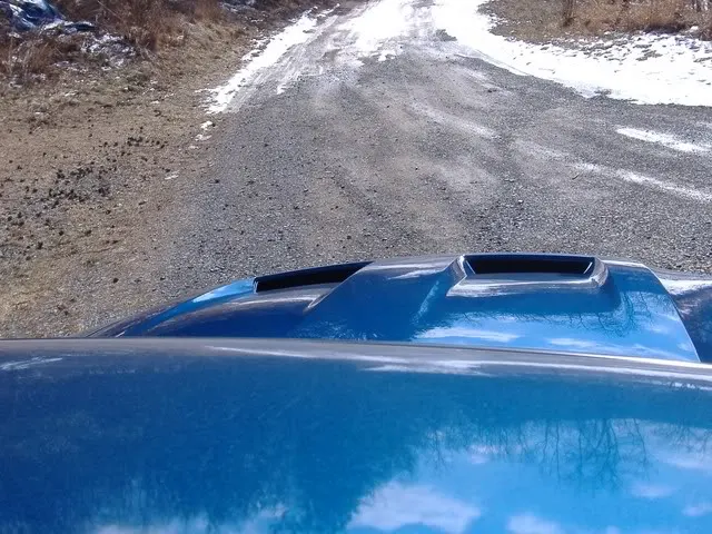

the hood is fiberglass from Mustangs Unlimited. Not a factory 03/04 cobra hood. are you guys mainly talking about the gap from the top of the bumper to the hood, or above the headlights? because I'll get the grille delete for the headlight thing, and im going to get my old body shop to put molding stuff on top the bumper that goes up so there isnt a gap there...
Try lowering your hood bumpers and see if the hood comes down any. The hood does look a little higher than the end of the fender. You could also try moving the hood on your hood hinges to bring it forward:shrug: if even possible
