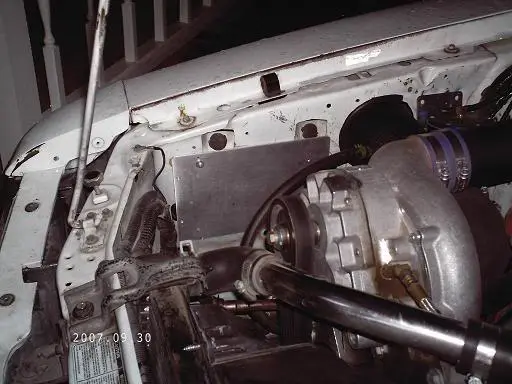

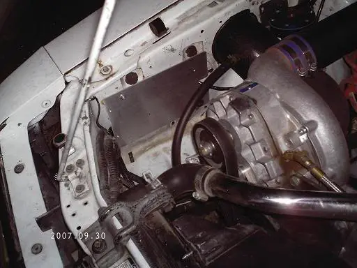

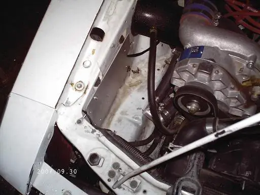

went out and got some pics for you.
i just took a piece of alum that fit over the hole well. cut a slit for the MAF harness to slide through and mounted it up. its simple. clean and works good.

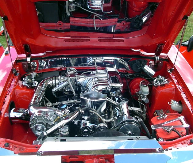

welded it shut w/the rest of the holes.
Damn, that is freaking beautiful!!!! I think I will try to fab up something that can be bolted in and have it either powdercoated or painted to match my engine bay, just getting around to it will be the hardest part
